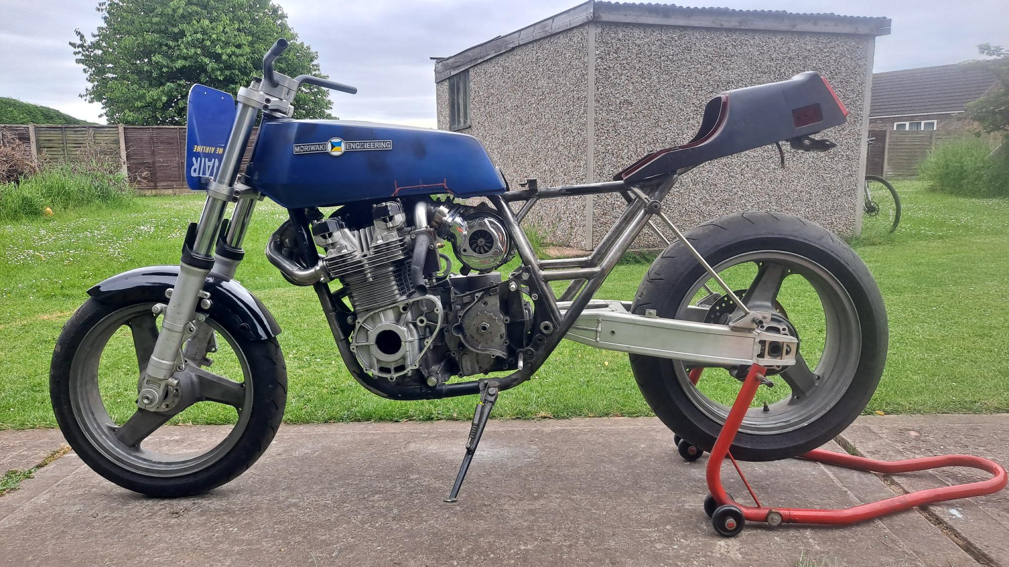

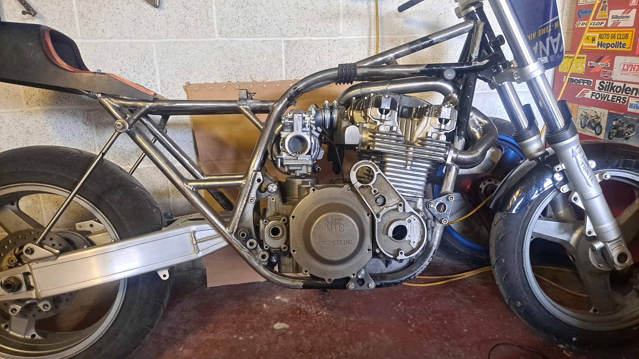

I'm currently building this.
It's pretty much the same spec you are considering with J head and 10.25 pistons but with zero deck height you will only drop the comp to around 9 to 1 with just the J head so will need a barrel spacer to get down to around 8 to 1 or slightly under.
The mls head gaskets are good for the increased pressure and will negate the need for piano wiring as long as the head and barrel surfaces are clean and free from any deep pitting.
Quick spec of mine.
Rajay f40, Mikuni HSR42 carb, HD case and barrel studs, back cut trans, billet 2nd gear, welded MK2 crank, 10.25 wisecos, MLS head gasket ( no O,rings ) , Ported J head with larger stainless valves, APE guides, hd valve springs, HD camchain, Manual camchain tensioner, Solid idler sprockets, GPZ1100 Unitrack cams on slotted sprockets , lock up clutch with roller pusher and Bill Hahn boost retard ign.
Quick spec of mine.

Rob that looks outrageous !!
will you need to "heat-shield" the underside of the tank so it doesn't vaporise the fuel with the header running under the tank??
- zed1015
- Posts: 3371
- Thanks: 2080
Re: turbo engine build recomendations. thanks!
24 Nov 2023 03:23Thanks, Should be fun when it's finished..
Yes! The link pipe will be wrapped with an insulation blanket that cuts down up to 96% of the radiant heat , The underside of the tank will be lined with reflective insulated adhesive mat that does the same and for proper belt and braces there will a heat shield that bolts to the redundant coil brackets.
The underside of the tank will probably experience less heat than it normally would..
