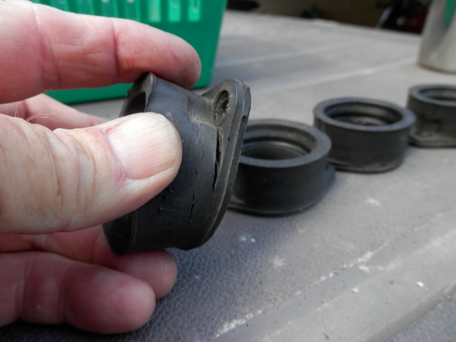

I've had carbs puffing back twice. Each time the cause was cracked carb to engine boot. I see you mention new boots so perhaps something like missing or cracked vacuum caps?......if your carbs require them.
Last edit: 27 May 2023 10:28 by JR.

Yes, I have new boots and they have rubber caps. I sprayed WD40 and didn't hear anything. Maybe I will try another fluid to check. What have you found works best for locating vacuum leaks?
