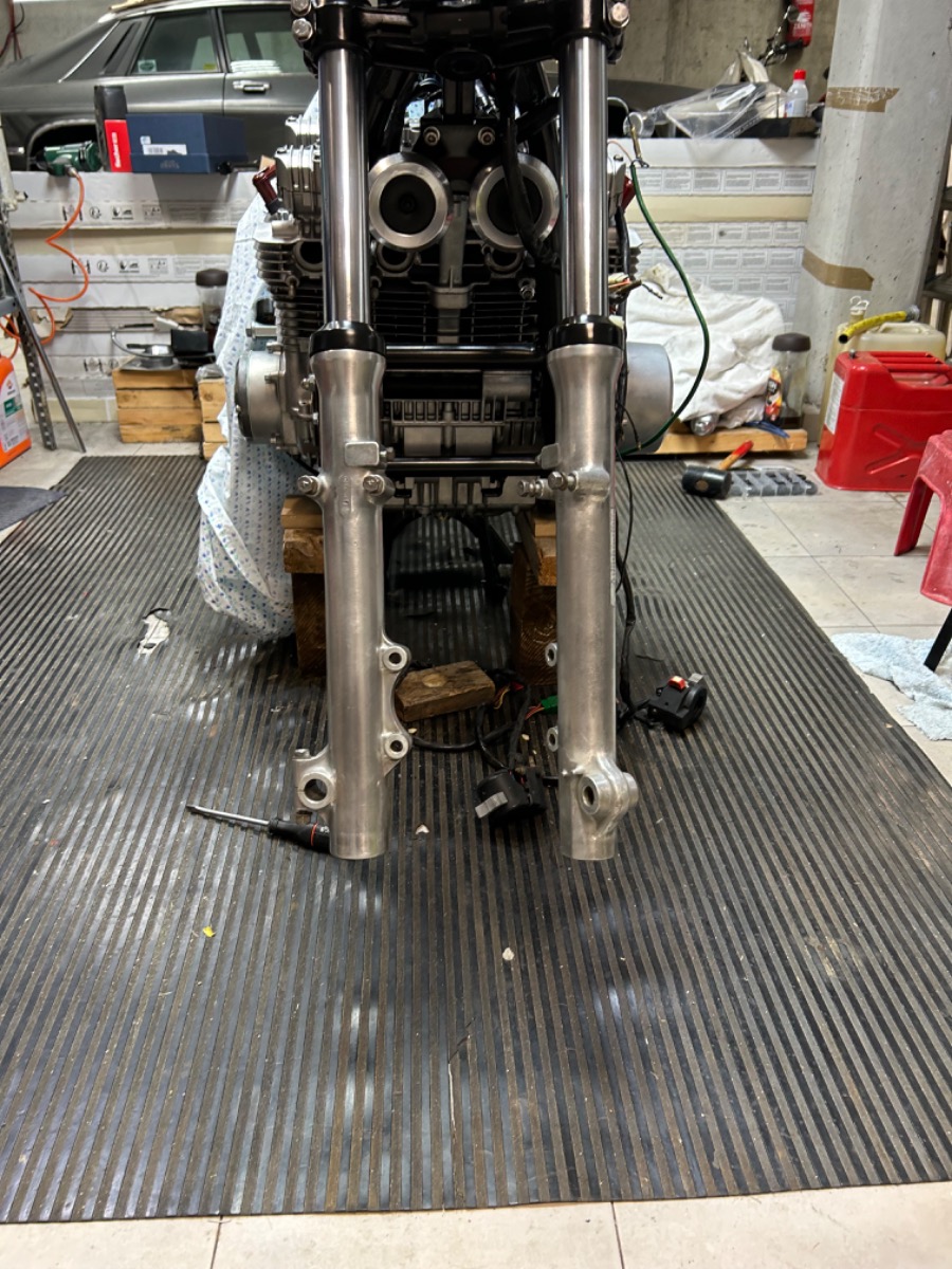

30 May 2024 05:36

Re: Piston Hole Kz1000LTD 1982
30 May 2024 10:21
Yeeehaw!
What was the problem with the forks?
30 May 2024 22:29
I was missing one of the bottom little springs!
The following user(s) said Thank You: TexasKZ
