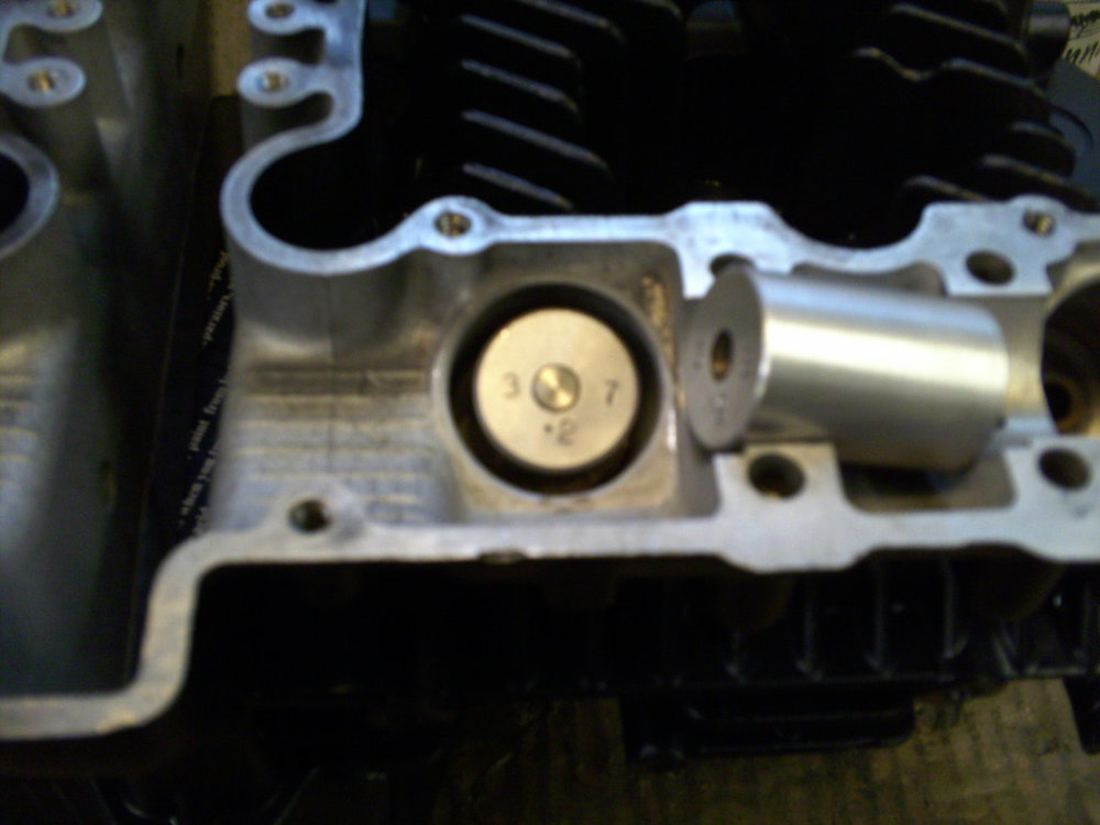

what's the best tool for measuring when checking your valve tipping length (for the DIY's) I have a 6" dial caliper but not sure if that'll suffice or maybe there is something better?

05 Oct 2022 12:13 - 05 Oct 2022 12:16You need to take the installed height measurement from the valve tip to the bare head with the steel spring seat removed.yes sir that's the information I was seeking.
and the double springs are to thwart floating the valves at high rpm?
If the valve is stock then you can take off 0.30 mm .
Any more and you can trim the collets and retainers if they are shim on top by a max of 1mm.
A vernier depth gauge can be used but that is tricky and can give inconsitent results even for the non diy-er.
A height gauge as in the pic of the correct minimum length is the only way to get reliable readings.

i do believe that .010" was taken off the valve, so from .11mm clearance with a 2.00 shim, so i'm thinking this should put my shimming in the 2.35 or 2.40 range?
