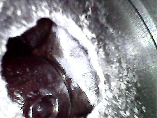

So I found my endoscope and checked out the left piston and it has a hole burned right through the center.
If anyone knows of a source for good pistons, that would be appreciated. Preferably some more durable pistons if possible.

I was trying to find some oversized pistons and rings one size up from the standard size (61mm) but I'm not having any luck. The standard size pistons that I've been able to find so far are usually pretty trashed by people hammering them out with a screwdriver/chisel and caveing in the dome on them. (I've already made the mistake of buying a pair of them from eBay and they're practically unusable.) As for the cause of the failure, I found an oil leak in the head gasket coming from the left side. I don't think that was the direct cause of the failure but I think it may have contributed to it at least a little. Not sure though. Seems my left carb was running lean and caused the piston to melt. Went ahead and tossed in one of the trash ebay pistons and put it back together. I'd like to do a proper rebuild but I would need a source for new pistons first and I would prefer to oversize them a little and bore the cylinders to match. Hence why I was hoping for a custom fabrication.
