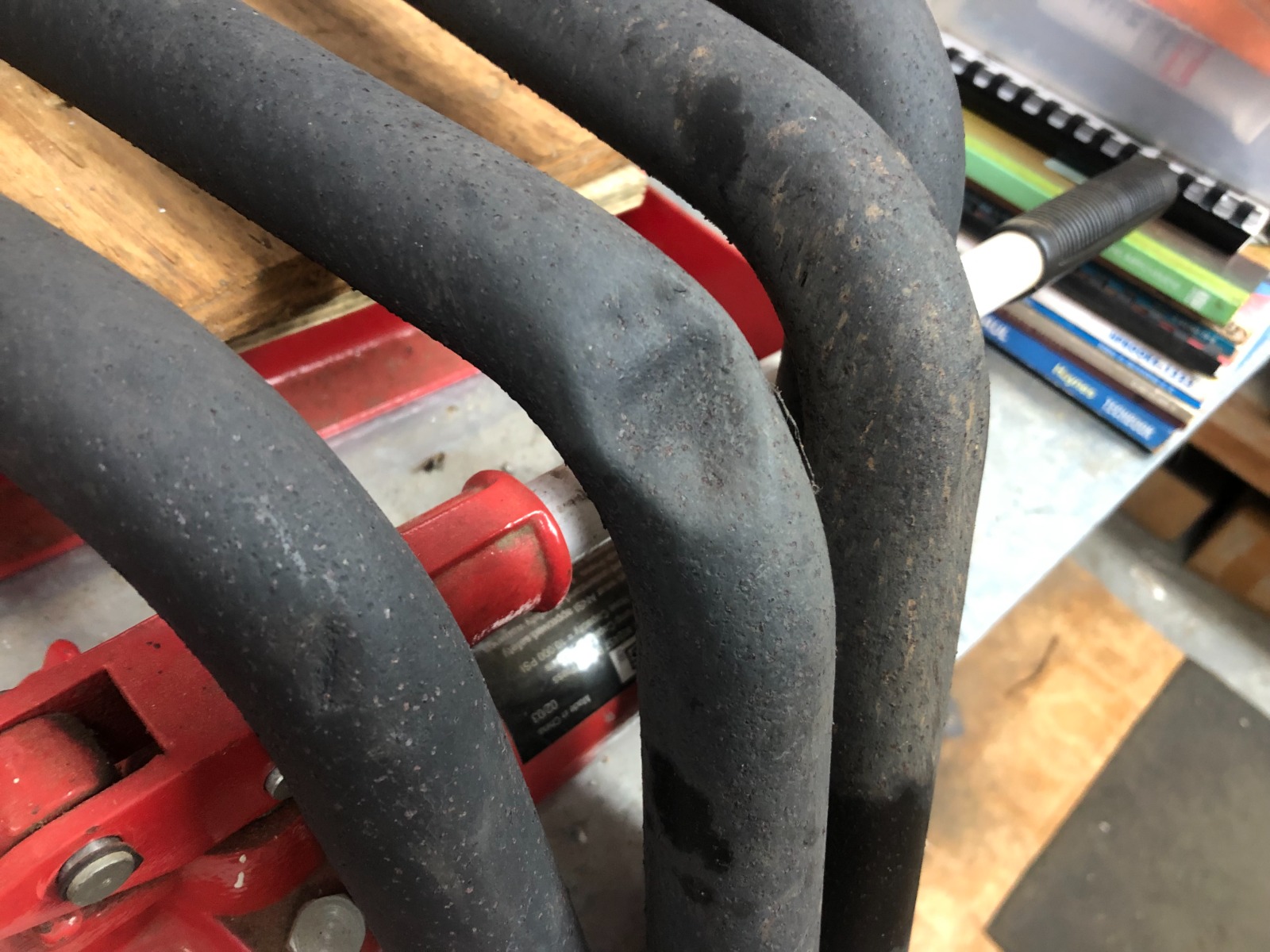

Hey All, the exhaust is off the GPz for a bit while I do some engine work. I really hate the finish on my pipes and was thinking of having them ceramic coated. i would like to have this dent repaired beforehand. Ideas? I'm thinking it would need to be cut out and replaced.

I've seen a buddy of mine seal off both ends of pipes making them air tight. Put a valve stem into the end somehow. Heat up the dented area "red hot" and blow compressed air into pipe.
I would make sure you do your own research on this method as I don't know if it was air or some kind of inert gas that won't explode when heated.

05 Apr 2022 09:13Usually done with compressed air but water ( hydroforming) can also be used as it does not compress like air so much less danger if the pipe splits.I've seen a buddy of mine seal off both ends of pipes making them air tight. Put a valve stem into the end somehow. Heat up the dented area "red hot" and blow compressed air into pipe.
Air method is to pressurise the pipe first then work the dent with carefully applied localised heat .

A easier way with minimum tools is to use a slide hammer / dent puller
A body shop uses a spot welder to fasten a rod to the panel then clamps a dent puller to the rod and pulls the dent out
Use heat to soften the area and pull
Check u tube for demo's

Watched being done on 2 stroke pipes, i tried it my self on a 4 into one about a year ago, didnt work, i was afraid to put up the pressure to high though, kinda chicken'd out.

This is an older Kerker so the metal is plenty thick. And, where the dent is is right at the bend. I'll probably take it to welder and get an opinion. I know a guy who teaches welding and is sort of the local guru for motorcycle frame welding. hopefully he's still around.

You can weld washers edge on to the dent and use a two legged puller against the pipe either side of the dent, that way you can apply constant tension while you heat the area you want to move

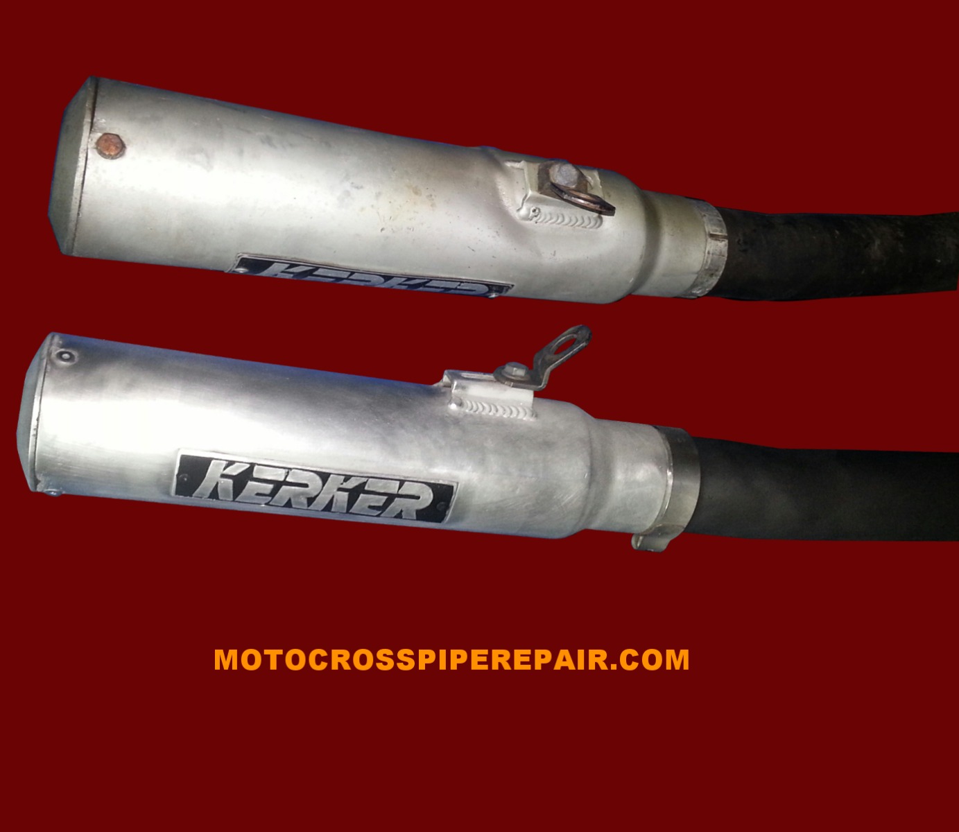

I had this guy remove dents from a kerker header a few years ago. The exhaust looked great and the price was reasonable.
motocrosspiperepair.com/
Edit: Here are pictures he sent of my own pipe when he finished it.

I've seen dents in pipes removed with large ball bearings, maybe look into that .

Either use dent balls:
or weld bits of metal on and pull the dents out with a slide hammer. Either should work. I'd probably try the balls first.
Ian
