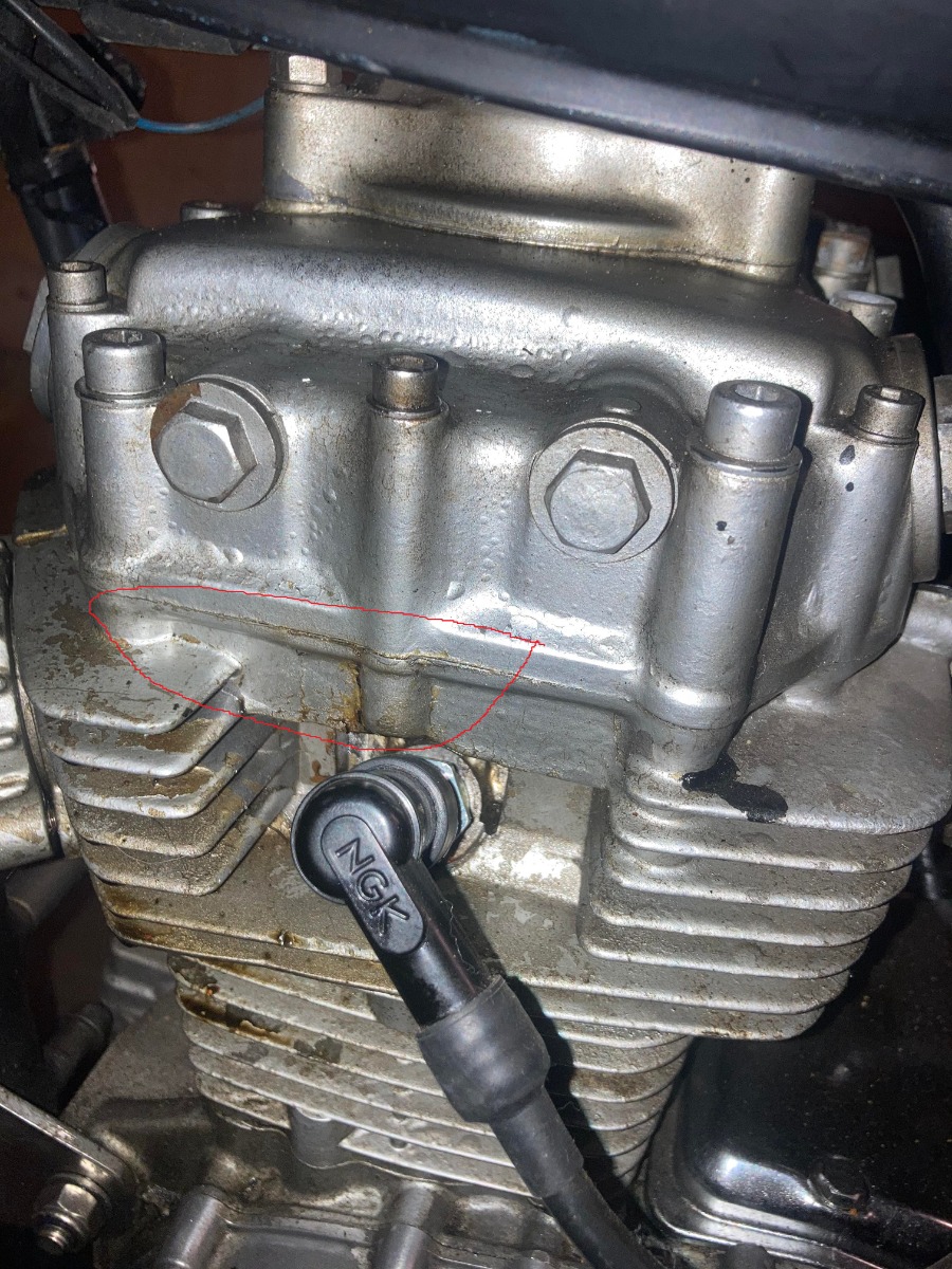

I recently acquired a kawasaki kz400 from 78 or 79. I recently noticed a leak in the cylinder head- by the joint in the picture.
I'm fairly new to this, so I'm unsure how I should go about fixing this. Any advice?
Thank you
Thank you

Im not a 400 guy but looks like a minor Gasket / seal leak
Clean the area and then monitor it
Next time please click the insert all tab to complete the picture install

I'm assuming taking it off and applying some sort of sealant will fix the problem?

No sealant needed. A careful clean and a new gasket should fix it.

You might want to hit up ebay and buy a real deal Kawasaki brand service manual for your bike. No Clymers or similar manual. Then go to Partzilla and look through the parts list. All the gaskets are shown. Don't get aftermarket gaskets, they are not as good as the originals. Realize also that when the cylinder head cover is loosened then the entire top end should come off because the head gasket and base gasket are likely to leak after the clamp load is removed.
All this is a lot of work and the gaskets are not cheap. At that point you may just want to leave the bike alone as long as it's not dripping oil all over the place.

A few drops here and there. Best left alone, then?

That looks to be the same as my 440 top end. There is no gasket there that I know of. I just make sure that the mating surfaces are clean and use a very thin layer of Blue sealer on the surface. The bolts holding it are only there to hold the top end. The head and base are held down with cap (?) nuts on the studs. I wouldn’t worry about the small amount leaking unless it really bothers you.

You can try retorquing the bolts. Crack them loose and then immediately reverse direction and tighten. One at a time. This rarely works once leaks occur but you never know. It should be part of regular maintenance regardless, but most people never do it.
