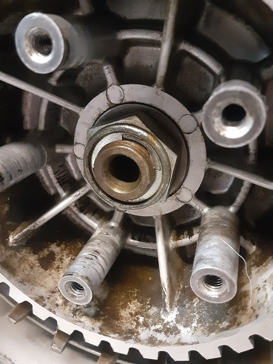

No marks on the clutch engine cover. Looks nearly brand new. Does this little ring on the clutch hub nut look normal?

- Posts: 23626
- Thanks: 2984
Re: KZ900 Pushrod Not Moving
15 Aug 2021 14:30
YES. SELF LOCKING NUT
