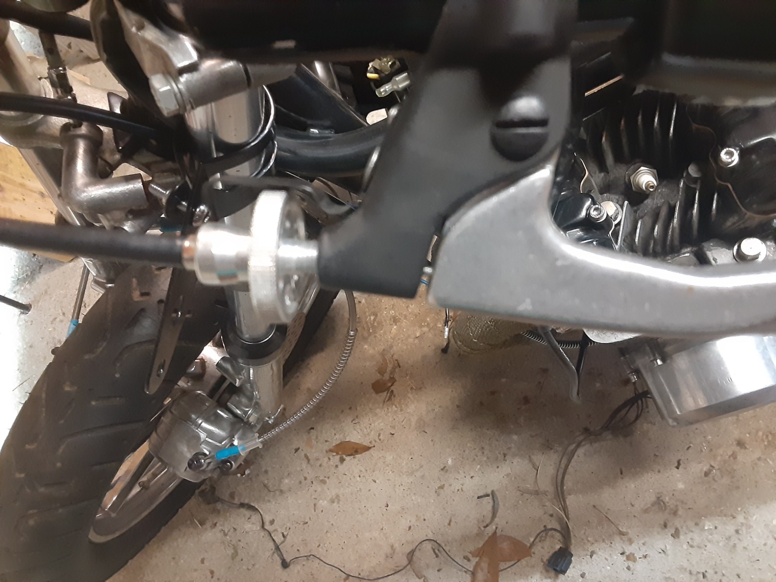

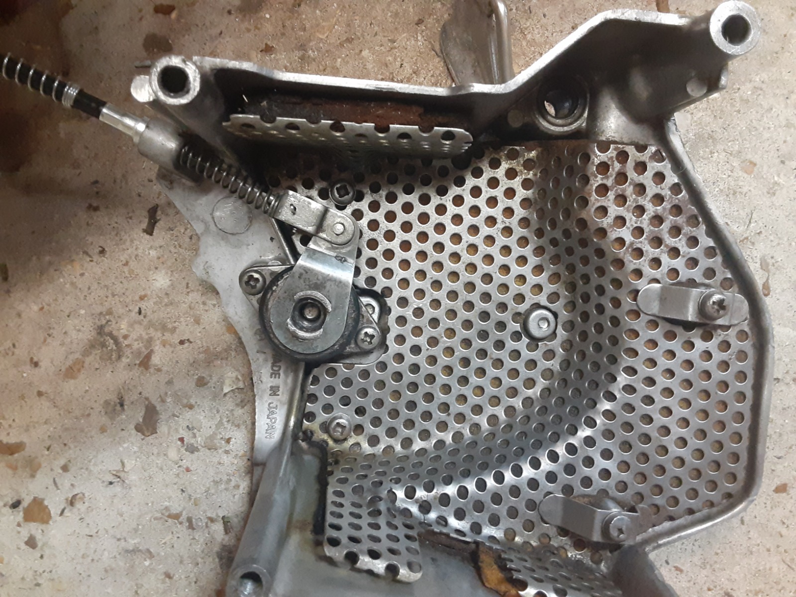

  • Lebowski
  • Lebowski's Avatar Topic Author
  • Posts: 39
  • Thanks: 3
Re: KZ900 Pushrod Not Moving
09 Aug 2021 10:52 - 09 Aug 2021 11:10
#853451

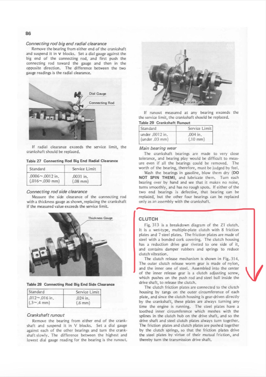

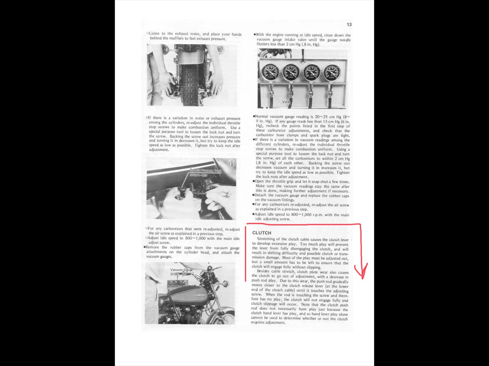

The bike is not in running condition yet. I will review those procedures and make sure I have done this correctly. Here are some pictures though:
