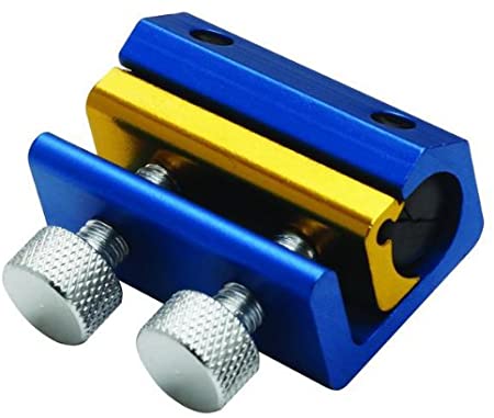

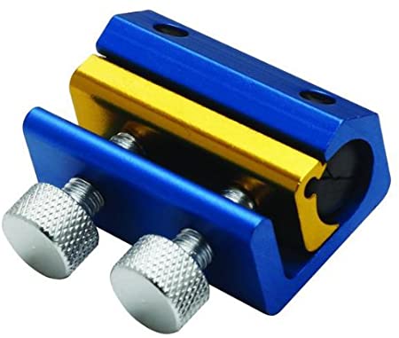

Make sure that the cable is properly lubricated. The Motion Pro lubricator makes this easy and relatively clean job.
