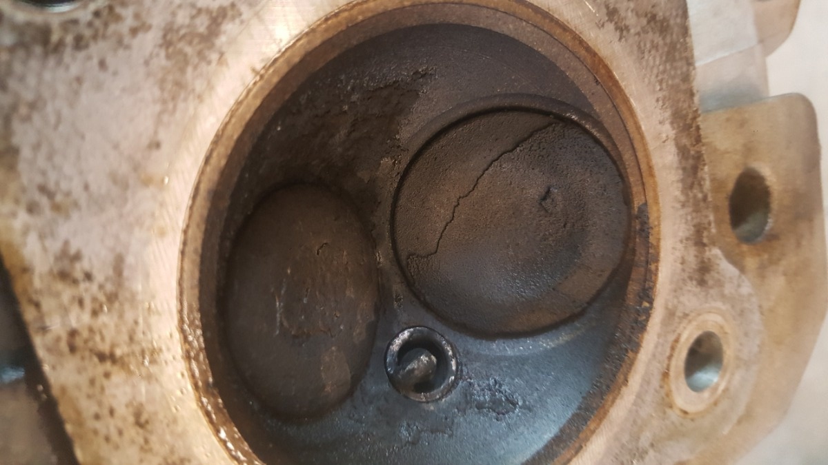

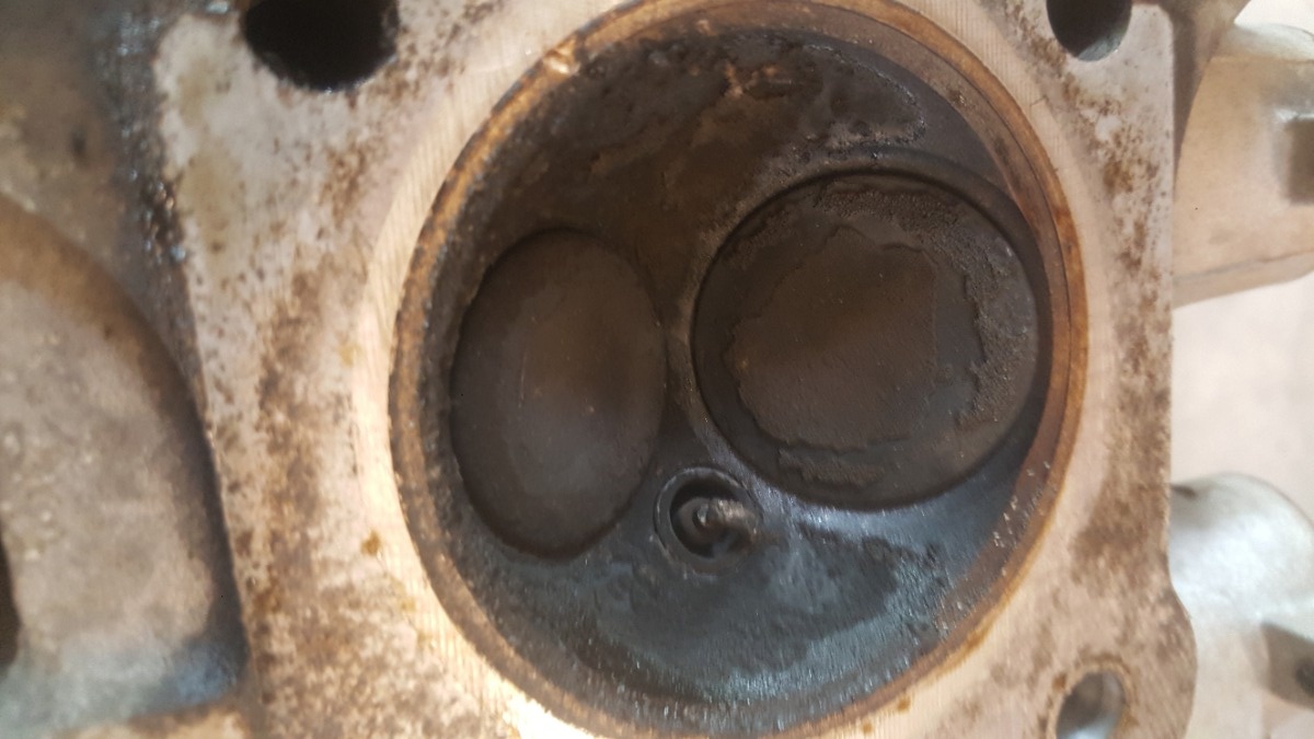

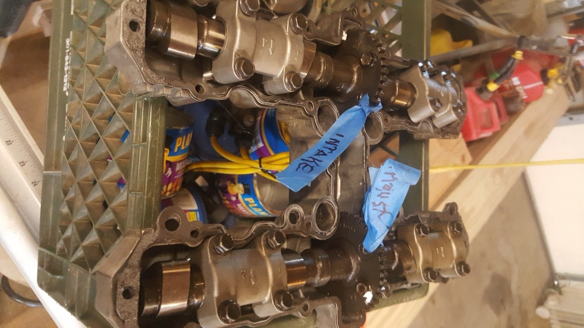

The $650 83 KZ1100 3 years of free riding are over.
Time to spend money and pull it apart.
Number 1. Others are dry, but probably not far behind.

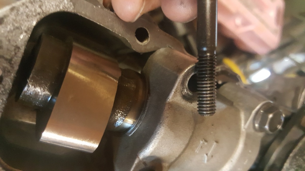

Cam caps are not easy. Impact hammer freed them. Strange some exhaust were loose. All the rest needed the hammer.
APE make cam cap bolts? Don't think I want to reuse those

How are the cam cap hole treads? I've had to helicoil a few, as others have pointed out the aluminum threads are a weak link.
Did you check the valve clearances before disassembly? Swapping the tappets with the cams out is infinitely easier.

I believe I got all the bolts out undamaged. Wasn't easy though.
I just reshimmed it to spec before I started tearing it down.
Don't want to reuse the bolts though.

Shouldn't be a problem. Mine are 40+ years old. I tighten them by feel. They don't have to be too tight and the torque is measured in inch pounds. Too many guys use foot pounds and mung up the threads.

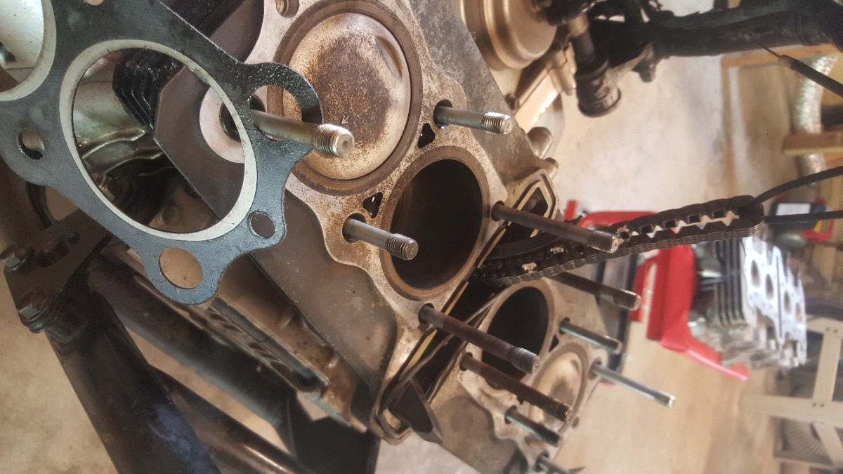

Re: Top end time
03 May 2020 08:10 - 03 May 2020 08:11

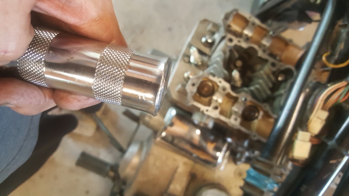

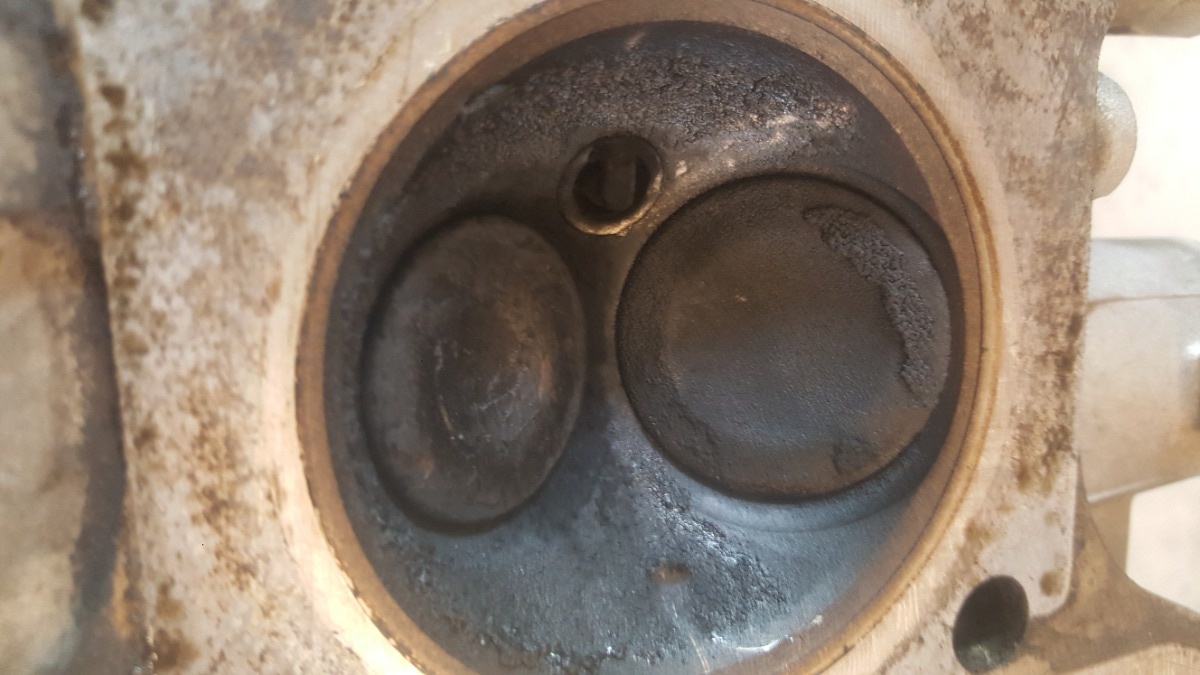

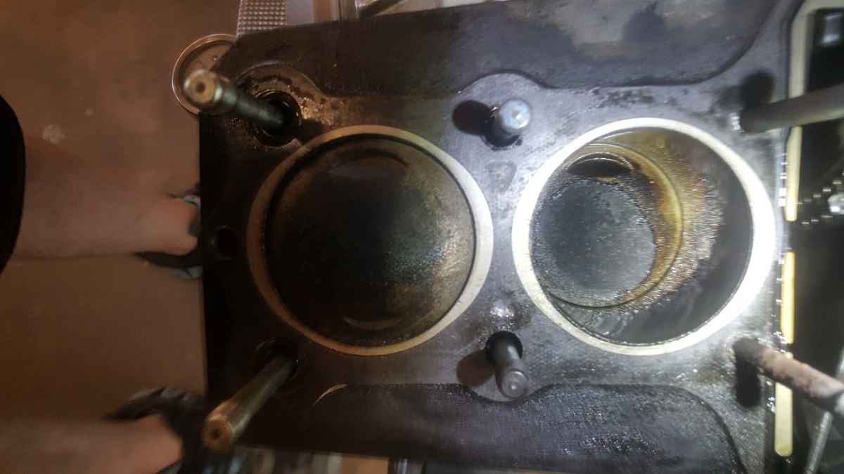

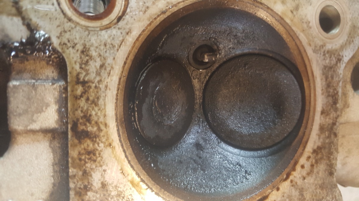

Head bolts darn near broke my impact hammer, but got them all loose and undamaged. Unlike the top of this impact hammer

- Posts: 15339
- Thanks: 2833
Re: Top end time
03 May 2020 08:34 - 03 May 2020 08:34
Next time simply soak the fasteners with Kroil for 3 days. No kidding - you will be surprised at the difference in removing them. Ed

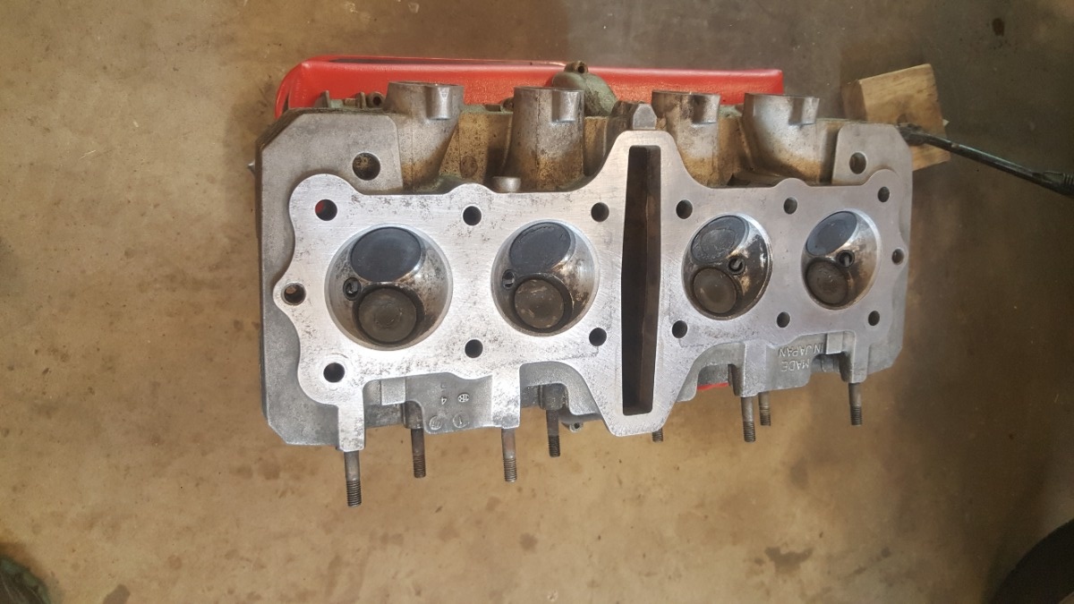

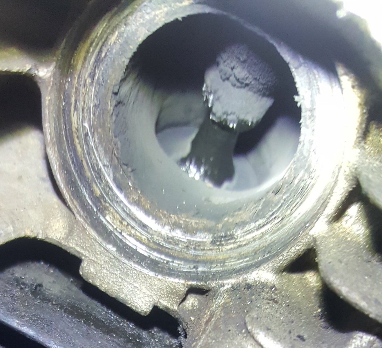

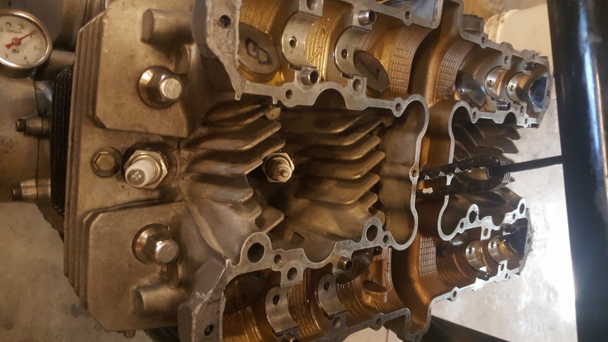

While I'm waiting on a valve spring compressor to arrive, what's the best way to clean this all up?

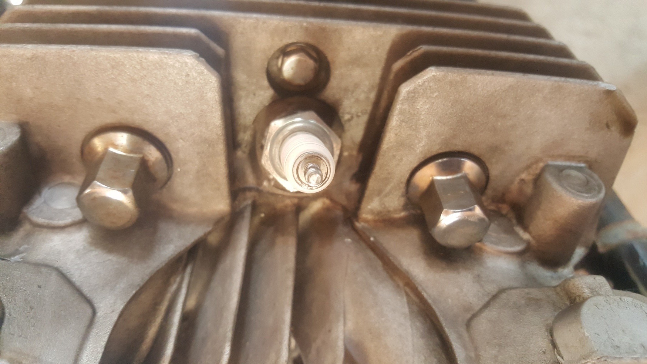

Light start on cylinder head surface. A lot came off with a toothbrush and solvent. Light touch with a scotchbrite pad. I'll get the valves better when I remove them for the new valve seals.
