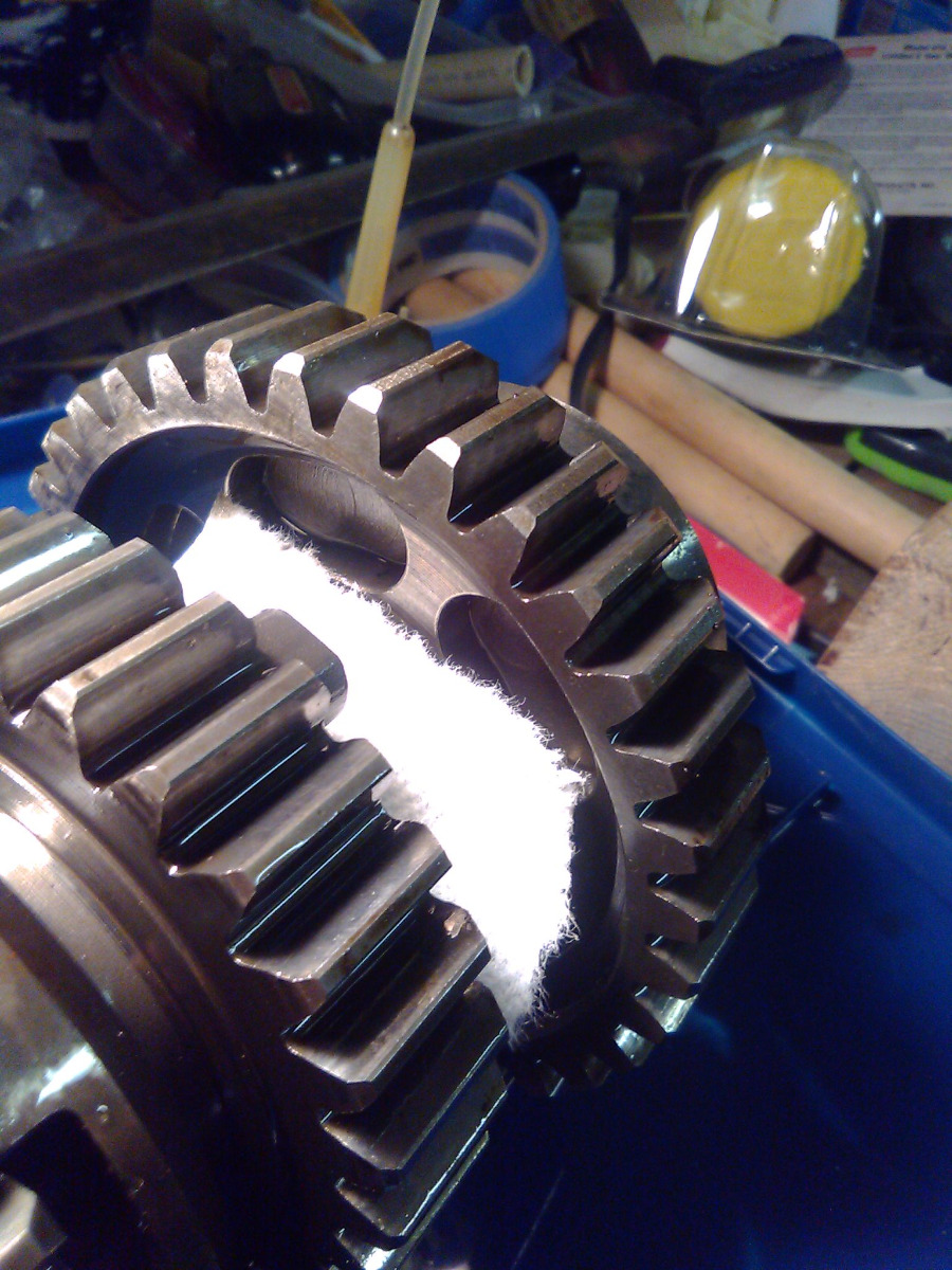

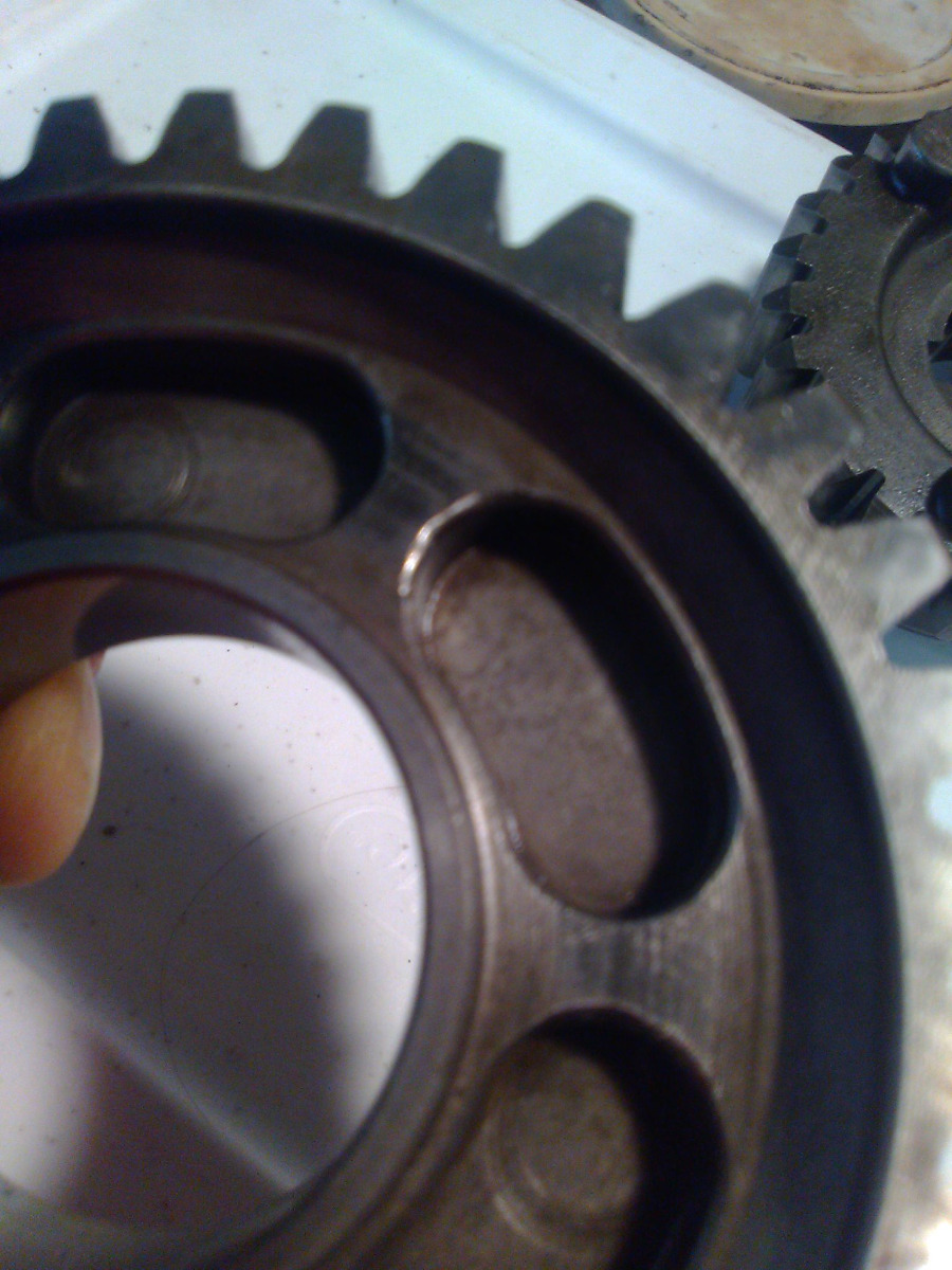

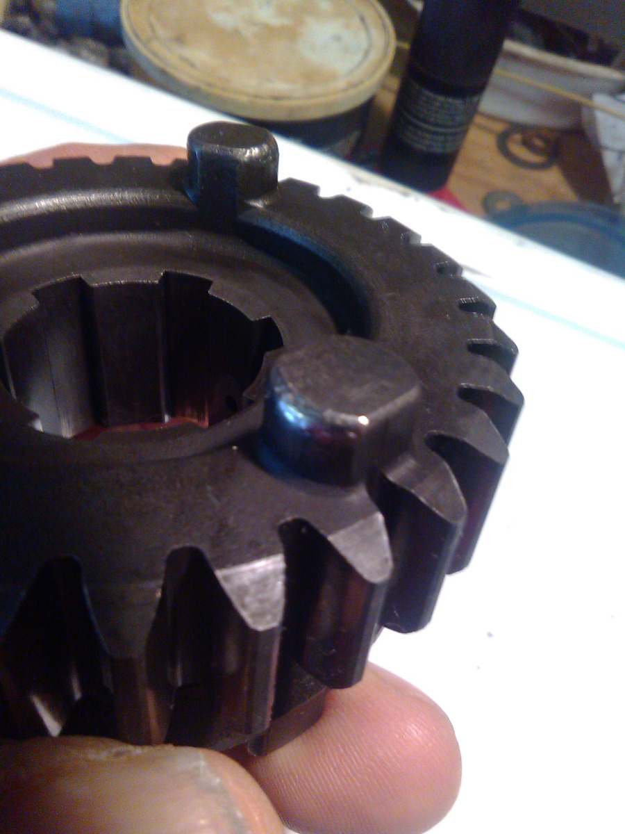

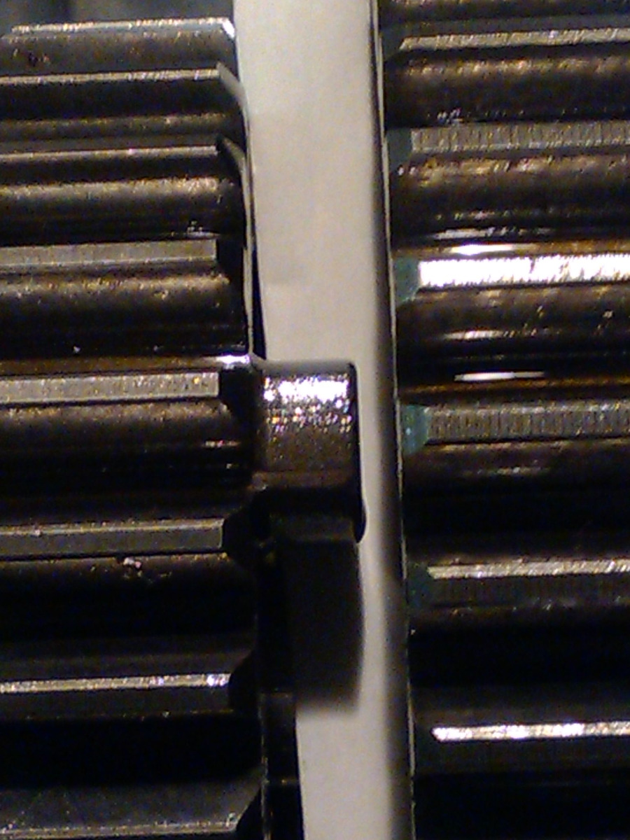

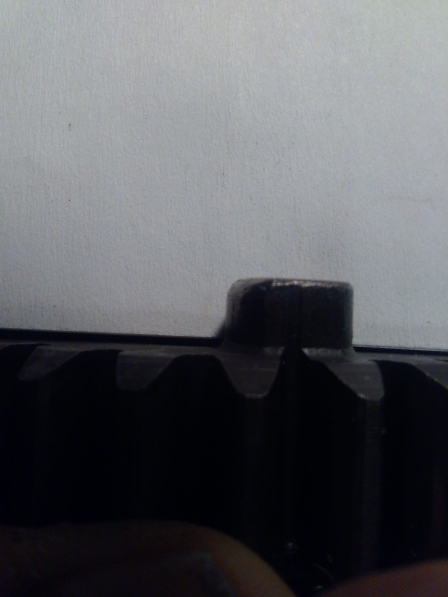

I am weighing my options, these are out of a 77 LTD 1000 that I was told had low miles, well maybe , but they were hard ones :pinch:
Can they be safely cleaned up or should I search for better?
I have another tranny in a motor that I hope is in better shape and I'll be check it out this weekend but if these can be saved I would rather keep those engine parts together.
I think APE will under cut 2nd gear for around 200 bucks( if I read it right) which is fair IMO

No eBay APP ID and/or Cert ID defined in Kunena configurationUndercutting should get plenty more life out of that but $200 ???
You can get a complete procut backcut tranny with a better low gear from MRE for $434 shipped.

08 Jan 2020 10:17Yep! it's cheaper to buy that with the after market low gears and also pay the extra $150 for the billet 2nd + shipping and import duty than it is to get my own stock one cut in the UK.Street Fighter LTD wrote: That is a smokin deal for all that

I wonder what they would charge to back cut for up and down shifts ?
Thats how mine is done

Thanks Zed, very interesting, have you tried one yet?
I wonder how much difference there is over a stock one, I mean I like to put the hammer down when the time is right but most of the time I am riding with the wife pretending to be a law abiding citizen and a stock tranny is all I need.

Yes but........... I would send complete trans out to be done !

I put one in the Orient express Funny bike about five years ago.
It behaves just like stock and takes 250hp no problem.
It was $350 shipped back then opposed to £450 to get our own cut with extra for the billet second.
I'm building a Turbo Z1R for the road and am dropping one in that.
I only put up the link though to show that you can get a better deal than $200 for undercutting one pair.

I like really like the idea of dropping a fresh tranny in the bike and not having to worry about it and the price is great considering the core cost and labor plus free shipping,
I plan on calling them.
As for just getting 2nd gear undercut and calling it a day, I'm sure that they have a dedicated machine and someone that knows how to run it but if I had to do it the cost would be a lot higher then 200 bucks, the last time I had it done was around 70,000 miles ago/ 1984 and it was only $75

Good news, the trans in my spare motor is in great shape so I think I'm just going to swap it out for that one and save some bucks
The spare motor is from a untitled 77 LTD donor bike I have and is going to get a total rebuild next Winter so the plan now is to drop a fresh M.R.E trans in it at that time, I hope they don't go anywhere.
