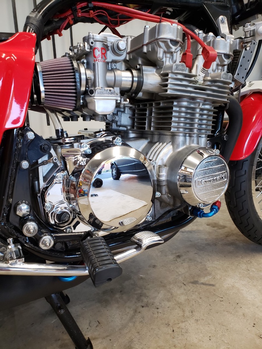

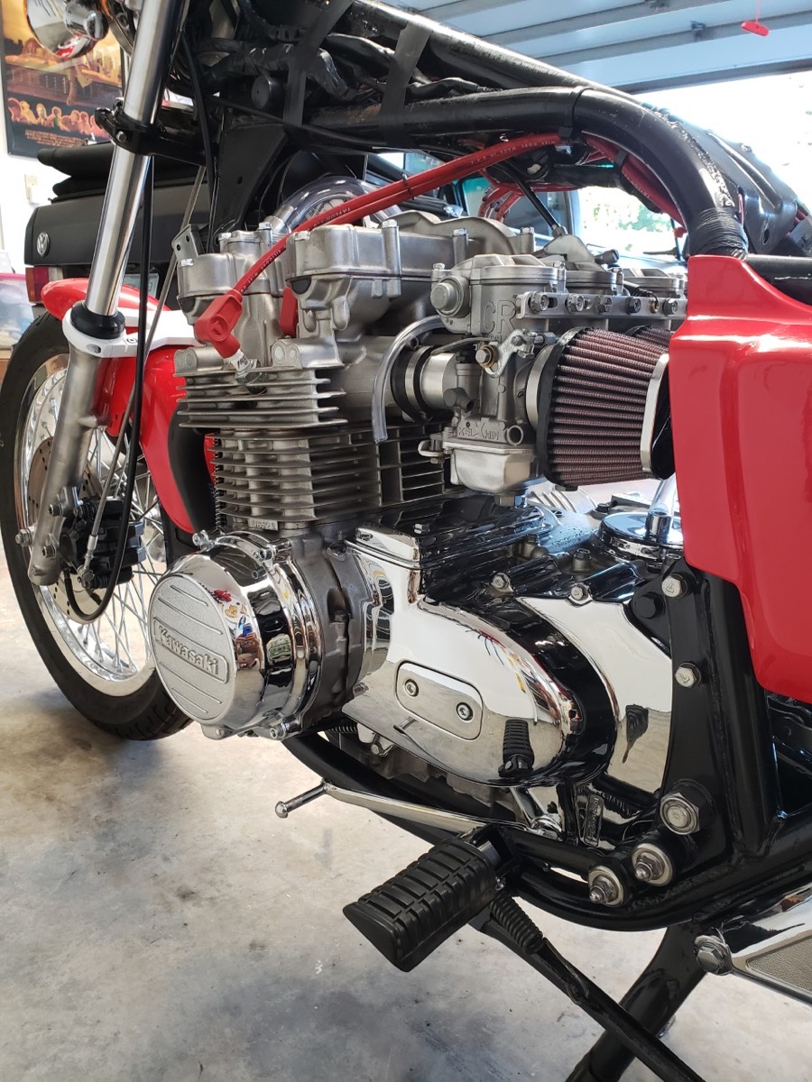

got to the point with my restore where first starts were this morning, cannot get #3 to fire ? ....my Keihin CR smoothbores are fully rebuilt & internally glowing clean, floats are operating perfect, Dyna coils sparking up hot, all new ignitor & rectifier, brand new plugs, etc, etc, etc .....pulled the #3 plug to check for spark (wire connected, grounded, hit start button): sparking away good, and even pulled #4 to check its spark comparatively and same exact spark (running NGK Iridium) .....also, swapped the #3 plug with the #4 plug to make sure it was not plug, #3 again will not fire, #4 fires perfectly .....what I did notice is when I pulled the #3 plug initially, it was not wet nor even damp with fuel, and I'm thinking it should get wet or damp from fuel when starting but not firing .....all jets are new, everything new for the CRs, full rebuild kit and an ultra meticulous internal cleaning .....question: can I pull the air filter (K&N separate pod) for the #3 and spray something into the carb while the bike is idling on the other 3 cylinders to get some level of fire happening for #3 ? just enough to hear the Supertrapp go to all 4 cylinders, just to deduce fuel / carb issue for #3 ?? if yes, what do I use ? and I'm assuming it would be sprayed thru the lower opening below the throttle body of the #3 carb from the air cleaner side, again, at idle .....all comments & guidance appreciated, thanks -
