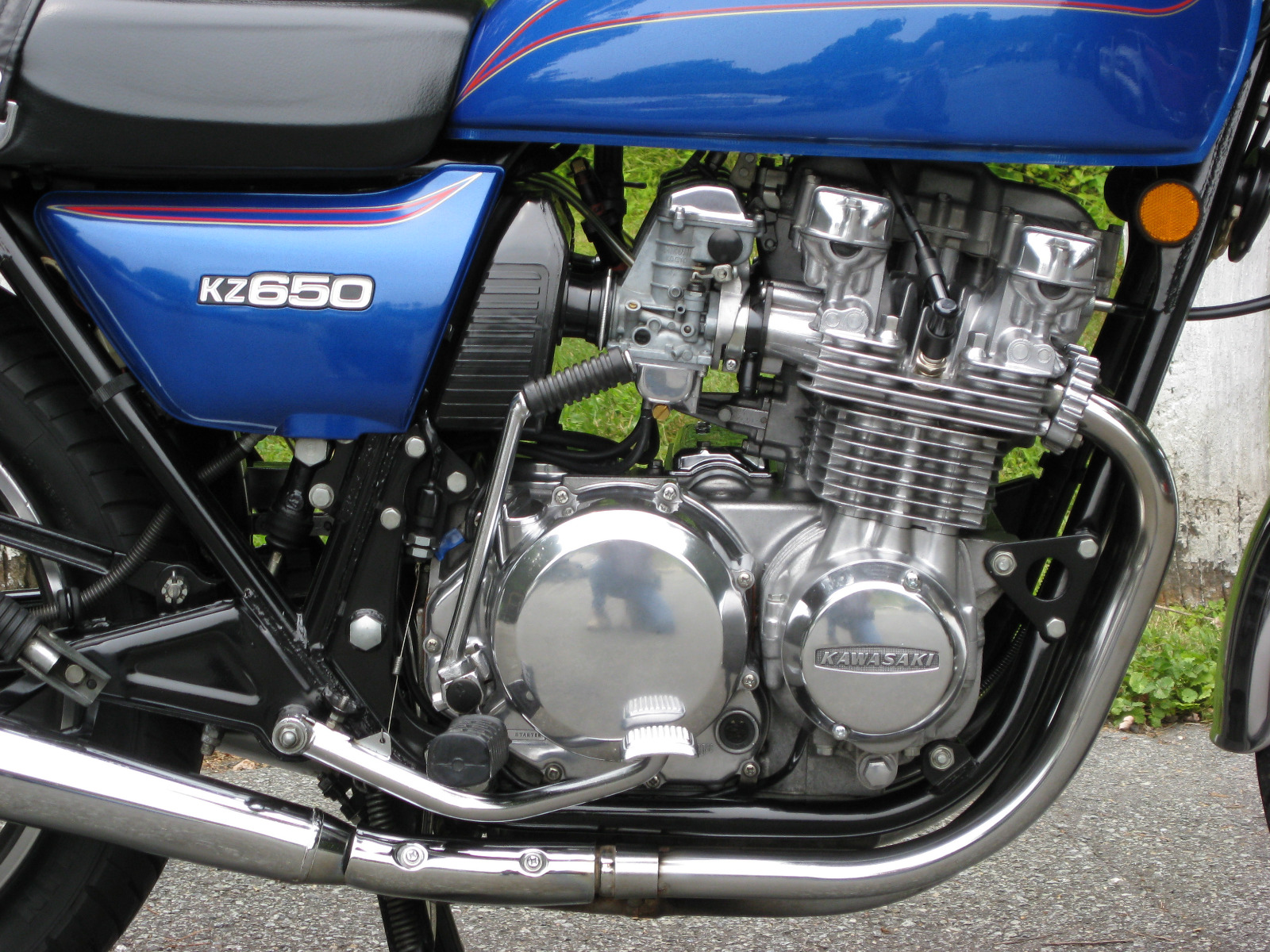

I guess to some degree it depends on the condition of the engine when you start. I cleaned my engine using metal polish. Yes, it took me several days, but when I was done I though it looked pretty good. Ed

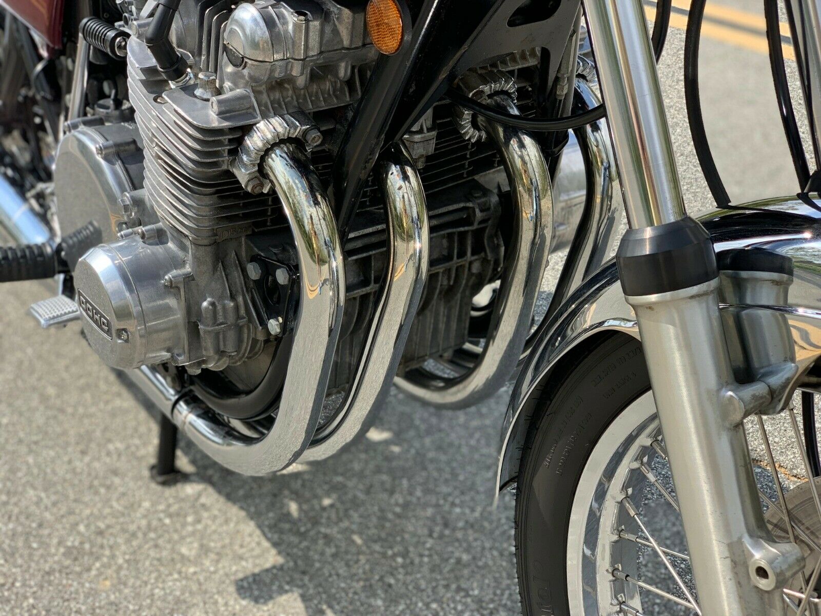

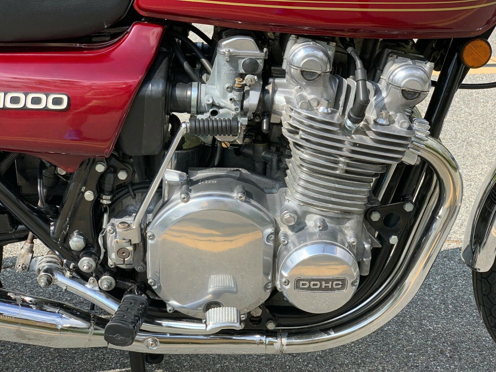

As requested here are two pictures of my engine. It isn't terribly dirty, but can definitely use some cleaning. The carbs have dulled down after all these years and I would like to spruce them up too. It was mentioned to use an ultrasonic cleaner on those, but what is the best cleaning solution for this? I guess I could go old school and use some Gunk engine cleaner on the motor and clean what I can with a high pressure power washer. I am somewhat confused on the Simple Green comments though.
are we talking "normal" Simple Green or something else?
Rick H.
1977 Kawasaki KZ-1000A1
Re: Engine Cleaning
18 Jul 2019 13:59
Your engine is far cleaner than mine was when I started cleaning it. I definitely would not use a liquid spray or other such cleaner on it. I would just use a bit of metal polish to bring up the shine. Ed
