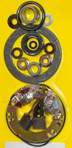

You would be horrified by the carnage in a worn out starter. If done early enough it can be cleaned up and rebuilt with a kit made for the exact year and model.

As a matter of fact, I ordered in the 4 brush "kit" for my bike, then took it apart to find it is a 2 brush starter with field coils rather than permanent magnets. I only cleaned mine up, then reassembled it. As you can tell, it cleaned up well.

Is it a good start take out the starter and clean it? Or is the best to replace parts with a kit?

26 May 2019 10:14gordone wrote: Is it a good start take out the starter and clean it? Or is the best to replace parts with a kit?
What is TLC?
TLC means "tender loving care" my friend.
I bought the wrong kit off of fleabay. The kit steve posted is the one I needed. I guessed what my kit was, (4 brush) and guessed wrong. It was listed for the right application , but was not the right kit. I didn't need it anyway.

I will take out the starter and take some photos to identify what kit I need.
