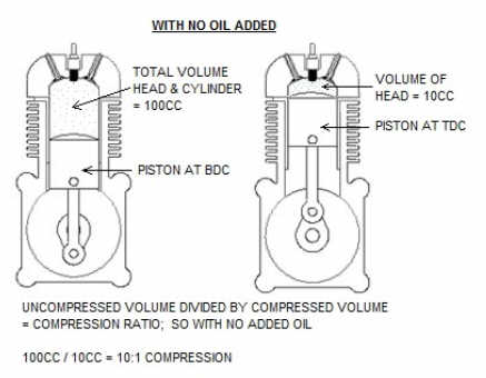

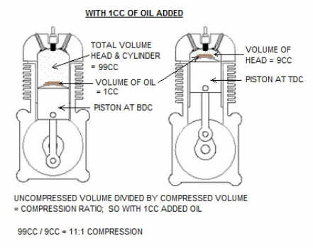

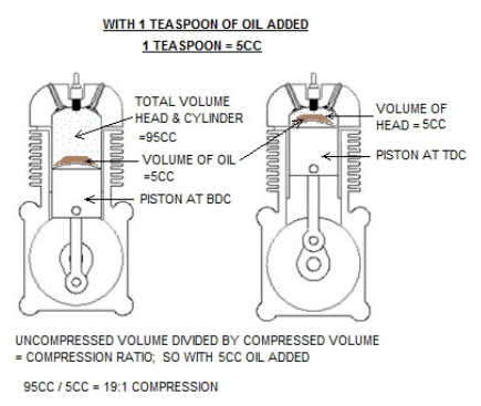

A leak down test should show if the rings and/or valves are leaking compression. Also, a compression test can show issues, but be SURE to follow the instructions in the Kawasaki Service Manual or the results of the test may be misleading.
If you decide to do a "wet" compression test by adding oil to the cylinders consider the following. Even a very small amount of oil added to a cylinder can make a big difference in the compression readings. I have seen more than one person advocate adding "about a teaspoon" of oil to each cylinder when doing a "wet" compression test. That may not sound like much oil to many folks, but a teaspoon is actually right around 5cc, and that is a lot. As an example of how little oil it takes to change the compression ratio I offer the following diagram. It uses a hypothetical cylinder with a total volume (cylinder & head) of 100cc and a dry compression ratio of 10:1. A little oil added changes things quite a bit, so if different amounts of oil were added to different cylinders one can see that the compression ratios might vary a lot. This example is not precise and is not any specific engine and it doesn't take into account oil that may seep past the rings, etc. It only is meant to demonstrate in very general terms how adding oil can change compression ratios even in a perfect engine. You can see how quickly the compression ratio jumps as a little oil is added to the cylinder. Ed
