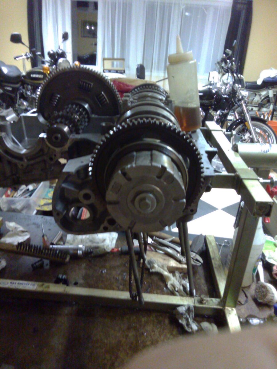

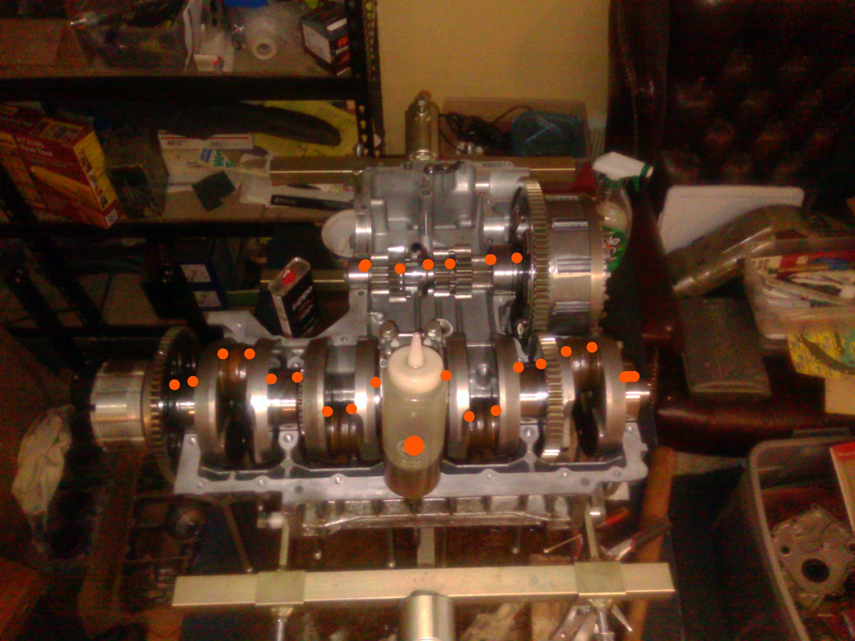

I add a shot to a squirt bottle filled with standard Rotella 15-40 heavy duty diesel motor oil and hit all the moving parts in the bottom end of the engine several times during the course of a rebuild turning the crank every time to help flush things out.

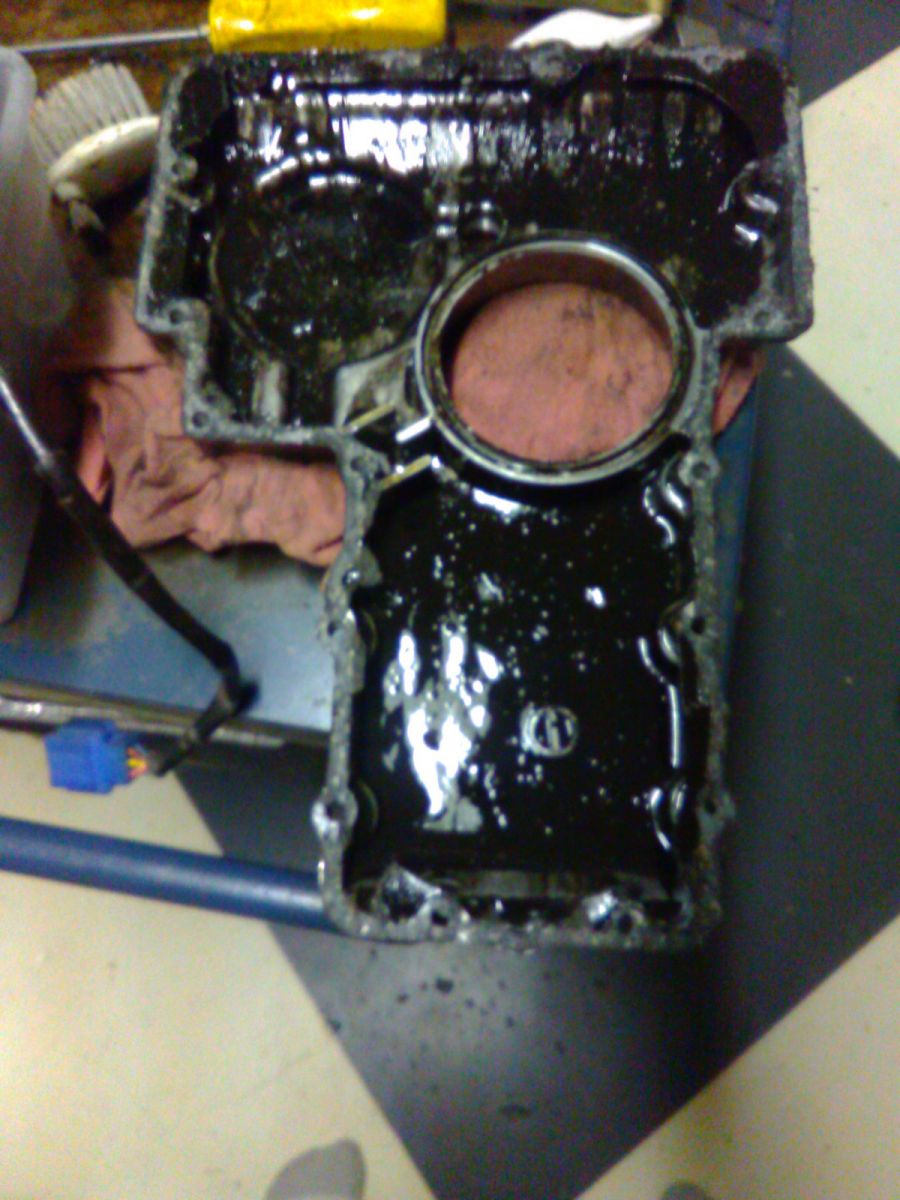

This is a spare 77 kz1015cc engine that I am cleaning up right now , it only has about 32,000 on it and was sitting for around 20 years.
there was oil in it but the pan had a thick layer of sludge on it, luckily the sump screen was clean so I don't think it was pumped through the engine.

Wow, nasty looking pan. I'm a Marvel Mystery Oil fan as I said. It is targeted at penetrating so what you are doing with it makes perfects sense to me. Nice looking work lined out there Bluej58. I love the engine stand shown. Purchased or one you made?
