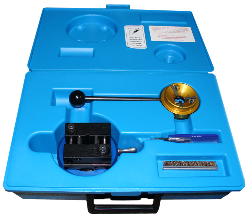

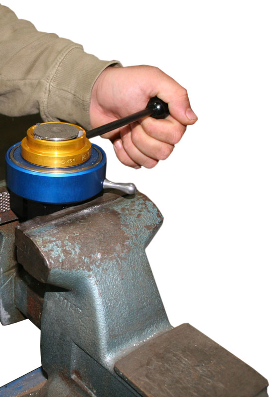

That sucks man. I don't trust most shops to do that sort of work. Better to pony up and send the head to APE or similar quality shop. Or, get some Neway cutters and do the work yourself! That's what I did anyway. I did trust a shop to clean up the valves using a centerless grinder. Hard to mess up with one of those.

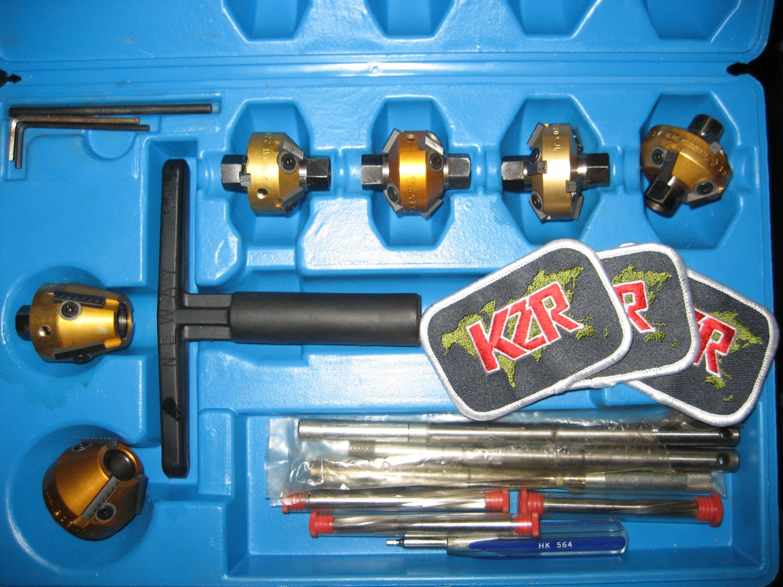

I bought a set of Neway cutters 20 years ago and do all head work by my self.

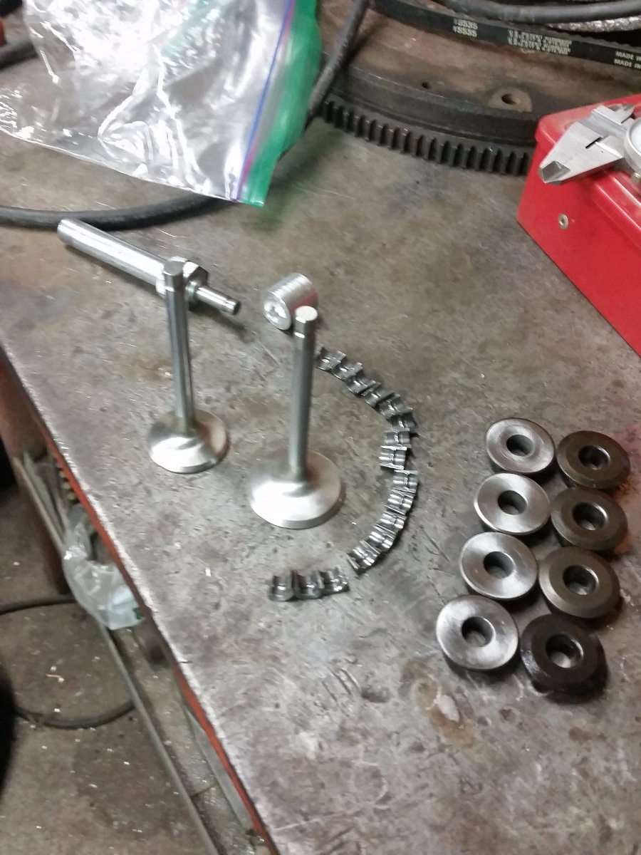

New valve seats aren't necessary, it's not uncommon to have the valves tipped, meaning to have the stem ground back to a set height. APE sells a gauge to measure the stem heights so you can adjust them to tune with standard shims.

Jay from APE wrote in an older thread that when the valves are really sunk, and the valve stems trimmed somewhat drastically to get the valve back to the proper height, then it may also be necessary to grind the valve keepers otherwise they will stick up above the valve stem after the spring is installed. He said that Police bikes sometimes get this sort of work done to get more life out of the parts.

Yeah, I forgot to add the part about checking the keepers! I've only had 1 head that I had to do that too!
Scirocco, I have been using Neways for years and they do a good job, I found using a cordless drill on low gave me better results that the T-handle. You're able to keep constant pressure and you can control the speed well.

I do the hand job with the T-handle, because only 2-3 turns max. are needed to get a smooth
seat surface and to correct the angles for the seat. The Tungsten carbide blades are very sharp and bite
easily into surface. I grid no more as necessary for a later valve job.

So I took it to a automotive shop and he recut the seats on a Serdi (really deep to get past the off center portion) and then after careful measuring, I had him tip the valves and cut down the valve retainers. Not one issue since.
