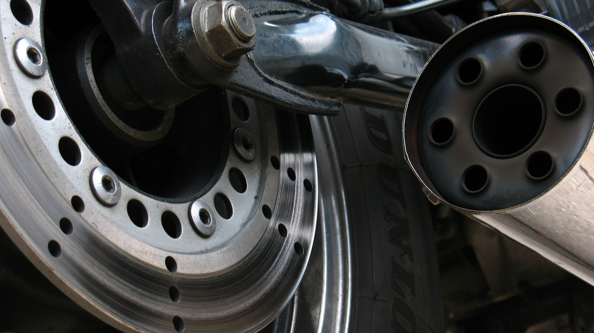

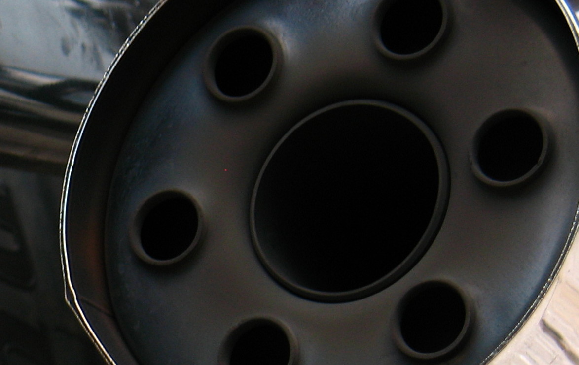

Far as the oil going out the tailpipe...
The outside of the baffle is dry (not oily) with a brownish color to it.
New Viton seals were installed early 2015, and that was just before this head was nutted on my engine with 42 ft. lbs. torque.
A wee-bit closer...
Been riding since early last year with over-rich jetting. Found that out when I had the dyno pull a couple months ago. Since then I've leaned it out considerably, and been thinking of trying the 15.0 pilot jets next time the carbs are off.

- Posts: 23786
- Thanks: 3051
Re: Low Compression?
10 Jul 2017 17:52
Looks good.
