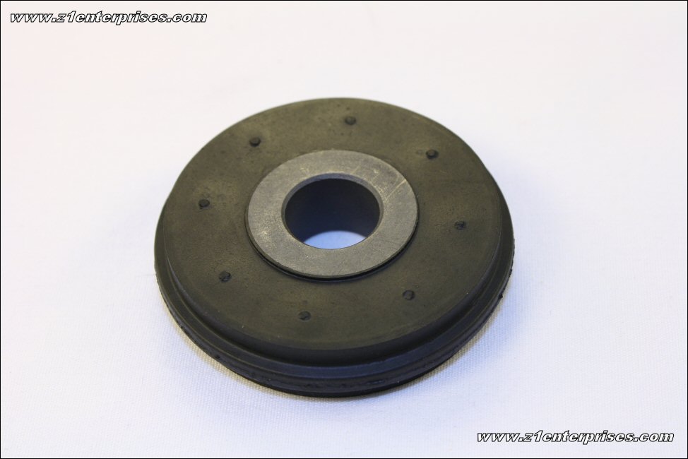

We see the rubber "donut" insert between the roller bearing and the chain tooth ring fail far more often than the roller bearing itself. A small amount of wiggle between the bearing and shaft is inevitable with roller bearings, more so than plain bushings.
See if you can press the rolling element out from within its rubber surround just by using your thumbs. If so, time for replacement. As SWEST says, it might be time to replace all the camchain tensioning components.

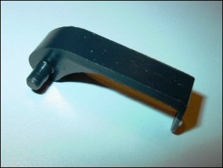

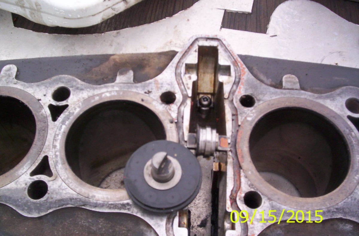

Re: KZ900 Top Idler Wear Help
01 Jul 2017 18:19
This is what can happen if the rollers go too long. The front guide is gone.
kzrider.com/forum/2-engine/597654-poser?start=80#690209

A new top idler looks like it has about .020". wiggle, not to be confused with side-to-side end play along the shaft. We didn't mike it, but that's pretty close. Looser than that or exhibiting any noticeable radial play calls fro replacement. That type of slop is usually from the rubber "donut" deteriorating that's between the outside of the outer bearing race and the inside if the outer ring gear that has the chain teeth around it. In that respect it's constructed the same as the lower idlers.
