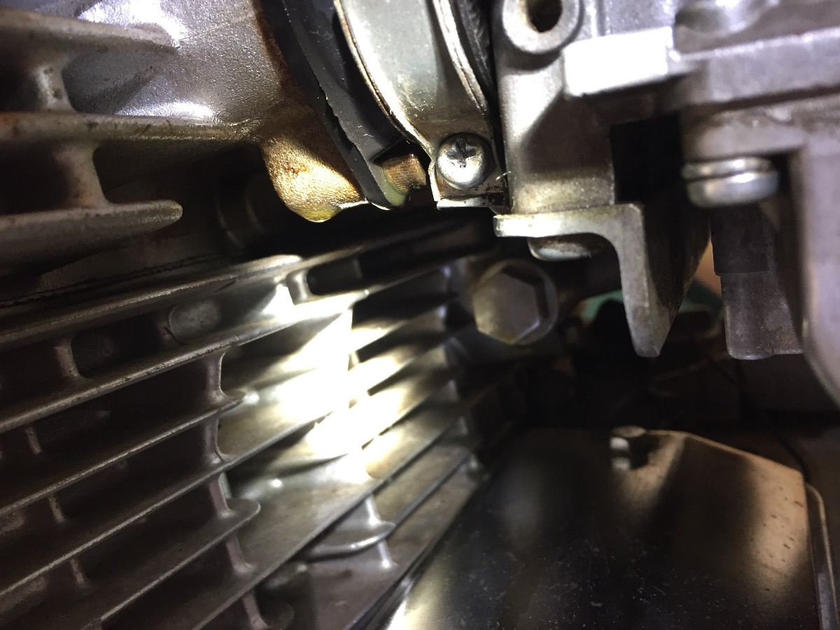

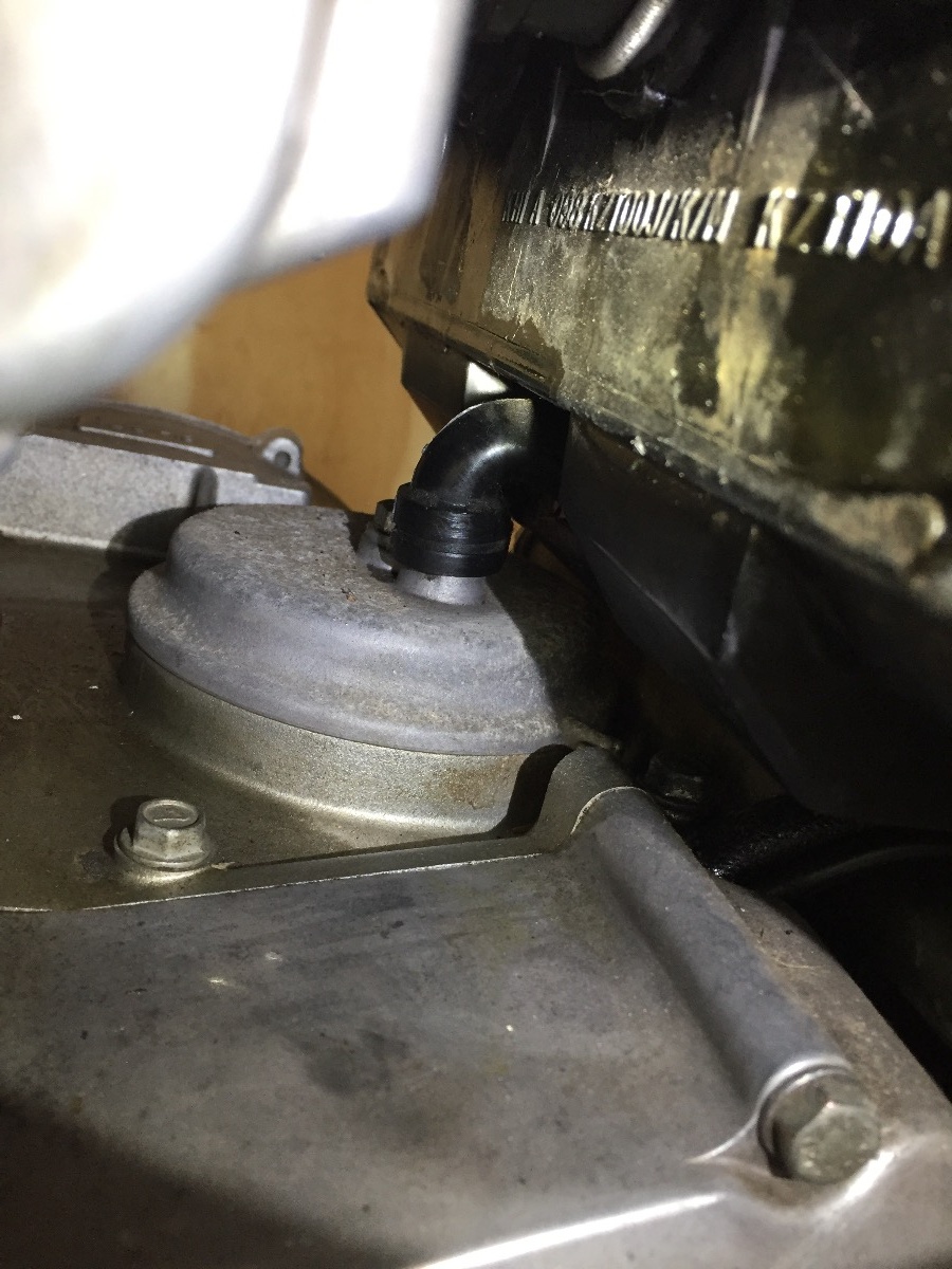

So when I got home this afternoon I found gas all over my garage floor. I don't have a good feeling about this. Looks like gas is leaking out of gaskets etc. any help?
I attached pics but may not be the best quality.

Can't pinpoint source of leak from the pics.
Leak may result from carb internal issue such as leaking fuel valve, or from an external issue such as a leaking fuel line fitting, etc.
Is the airbox filling with fuel?
Do the carbs have overflow hoses?
Is the petcock being left in PRI position? If leaking somewhere after the petcock (in OFF, ON or RES), the petcock isn't stopping fuel flow as it's supposed to, which allows fuel to continue flowing on to wherever it's escaping. In which case there's a petcock issue as well as the reported fuel leakage issue.

After going back and looking at the pic.'s first thing I'd do is new carb intake 's and factory clamps.
