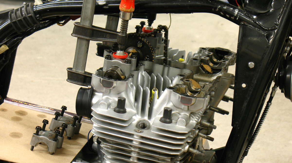

I think the threads had been pulled loose by repeated over-tightening of the bolts over time, or where too much torque had been exerted when the bolts were started into the first few thread turns...which is exactly what happens when the bolts are used to pull the caps/cams down.
Think about it...at-least 12 ft. lbs. of torque gets applied when using the bolts to draw the cams down, and that alone is enough to weaken and pull soft/weak aluminum threads out :whistle:

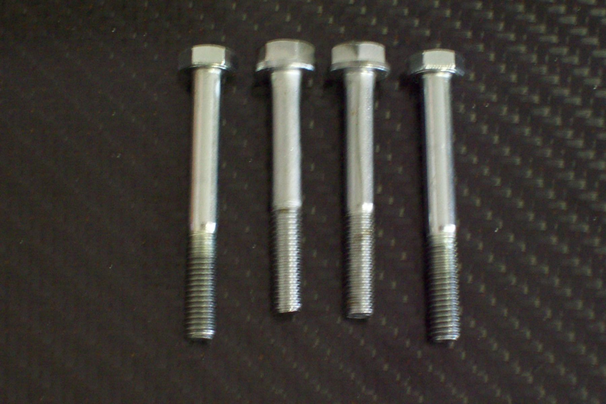

Here is another trick I have used when installing big lift cams in KZ heads. Go buy yourself some 6X50MM or 6X55MM bolts. Replace the standard 6X45MM bolts with the slightly longer bolts, and bring your cam caps down to about a 1/8 of an inch of the head. Then one by one replace the longer bolts with the standard 6X45MM bolts, and then bring the cam caps all the way down to the head, and torque to 78 to 95 inch pounds. You can use the longer bolt trick with stock cams too!! If you strip the cam cap threads using the longer bolts, I would suggest you find yourself another person to assemble your motors!!! Don't save a few pennies, and buy some cheap-ass hardware store bolts either. Fastenal sells a high quality bolt.
