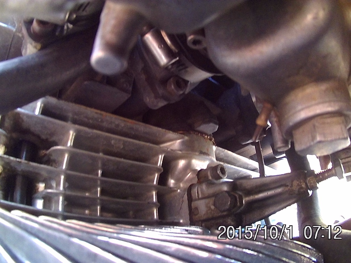

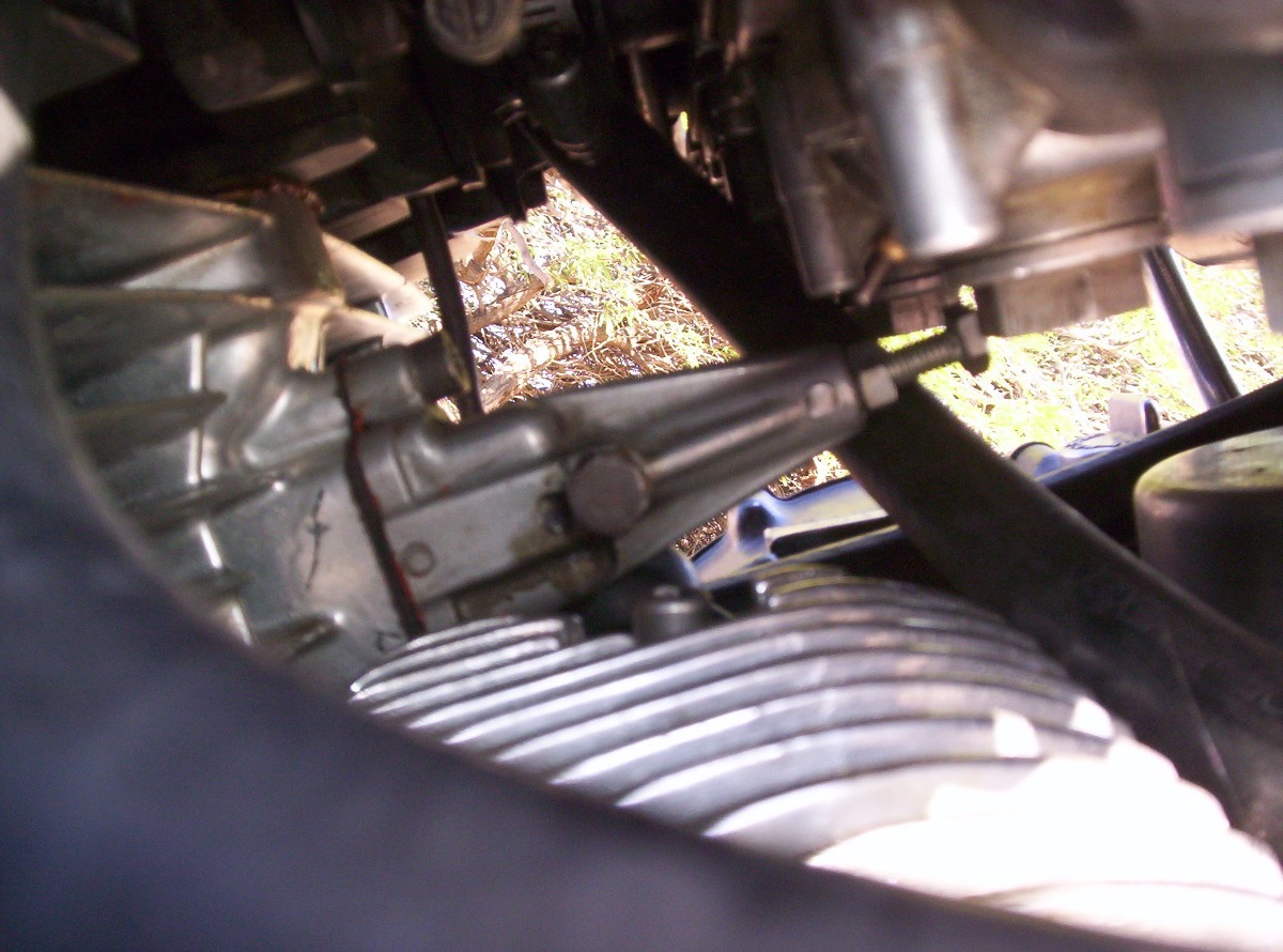

I have the old style adjuster. The ramp got worn so it would loosen. I installed a bolt at the end to prevent that. I had a aftermarket one but it was too hard to feel when it was tight. I ruined the center roller and guide. I went back to the old manual one.
