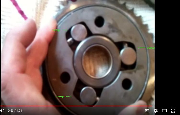

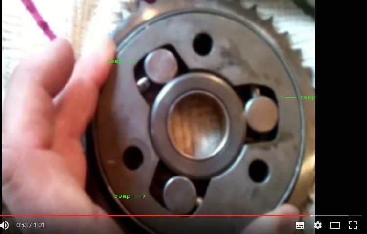

- Posts: 15339
- Thanks: 2833
Re: Kz750 starter clutch repair failure
12 Mar 2017 10:41
The following user(s) said Thank You: GPz550D1, KZB2 650, slidinsideways

My starter clutch gear looked like Ed's "used" gear and it works fine. In fact, every starter clutch I've ever seen look like that. I get that wear on that surface can be bad if it goes beyond some point, just understand that some marks on the gear doesn't necessarily mean the gear is bad though.
- Posts: 4420
- Thanks: 2268
12 Mar 2017 13:30
The "used" gear surface is normal and it will works fine
if the roller housing is out of spec (worn out ramp) you have no proper functioning.
The starter clutch is a combination of direction of rotation, traction, friction and form closure.

I noted that the difference in diameter between the new and old rollers was tiny. I suppose bigger rollers, new gear, may not even solve the problem - depending if the ramps on the housing are worn.

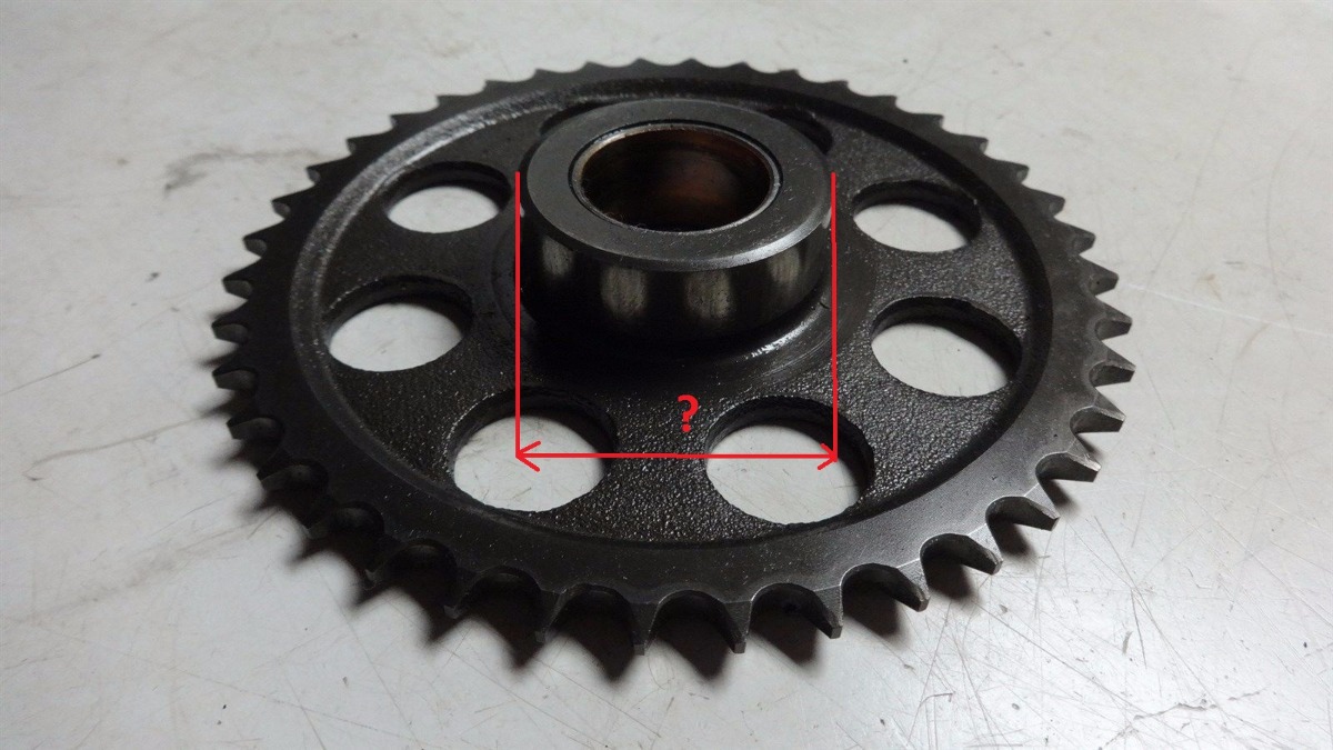

Hello, I read your topic and I have a question.
The starter clutch of my Kz750 is damaged. The only way how to fix the problem is to make a new starter clutch gear. In order to do so I need to find out the accurate diameter of the part which runs on 3 rollers in the clutch assy. According to my information, the diameter must be very precise.
Can anyone help? Thank you.
I attach a photo
I attach a photo

22 May 2017 12:37krojci wrote: Hello, I read your topic and I have a question.
I attach a photo
It's available from Bike Bandit it appears.
www.bikebandit.com/oem-parts/detail/kawa...?m=150535&sch=425106

Unfortunately, he needs the part for a 1978 KZ750-B3 twin rather than a 4-cylinder KZ750, so that part won't fit his bike. He could help everyone help him if he would add his bike's year and model (1978 KZ750-B3) to his signature line.
It would save a lot of energy if there was someway to force members to to that. Ed

Just from my experience I wouldn't take the diameter of the hub of the sprocket as a real indicator of wear.. sure it probably plays a part, but from what I saw (and I am sorry I didn't take photos of the work housing) the ramps were a clear indicator of the wear.
