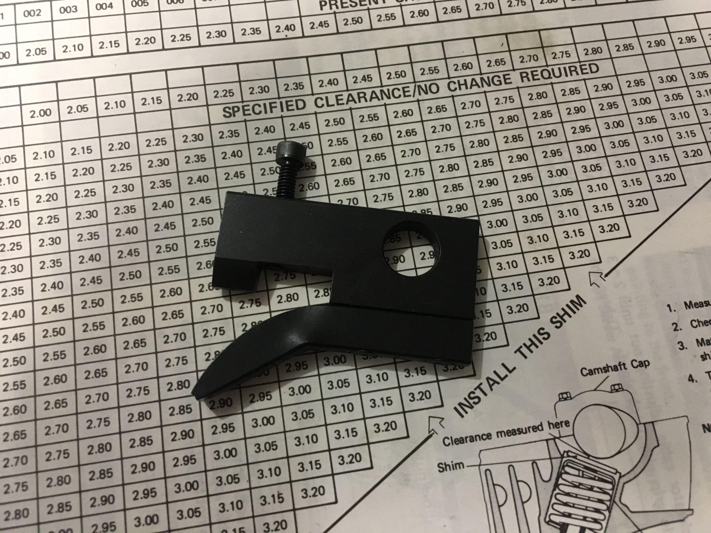

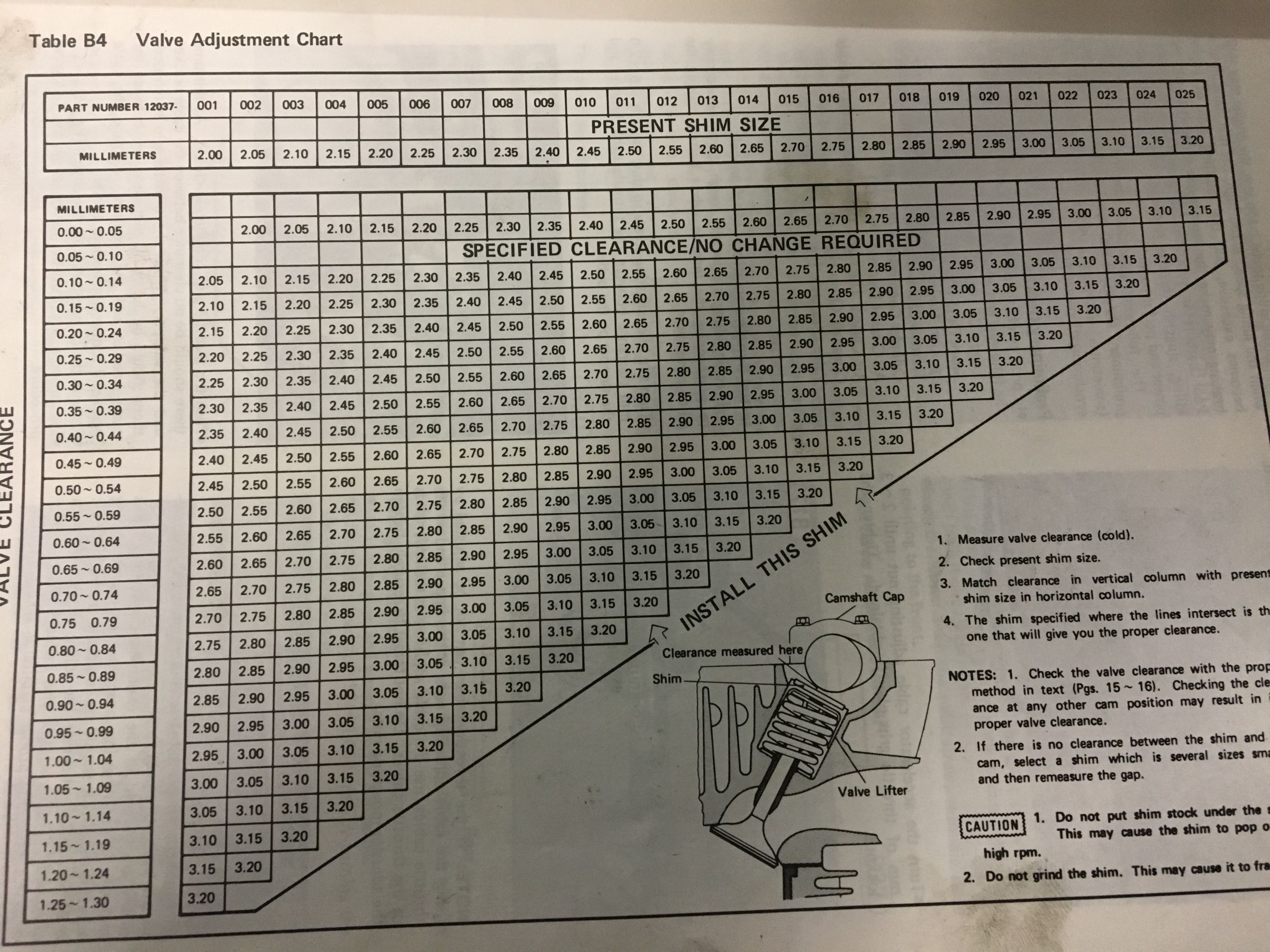

- spdygon
- Posts: 1005
- Thanks: 115
Re: Probably a really stupid question
13 Dec 2016 17:57
1978 Kz1000 Z1R. 10K Miles1
1978 kz1000 z1r 27k miles
1976 Kz900A4 (Red)21K miles
1976 Kz900A4 ( Red)7500 miles
1974 Z1 900 project
1974 Z1 900 project
13 Dec 2016 19:14
I ordered that tool and it was like Christmas when it arrived. Couldn't wait till I could pull those shims and find out what size I had. I really enjoyed doing the math to figure out how to get the right clearance. I had a very well known 900 builder that told me these bikes like to be set at .002 to .004 thousandth on the intake and .003 to .005 on the exhaust. I set mine as close to the middle of those ranges I could so .003 intake and .004 exhaust. I'm impressed with how well the bike runs now after setting them
- slmjim+Z1BEBE
- Posts: 1622
- Thanks: 1096
13 Dec 2016 19:14
The only one we'd touch is #2 exhaust.
You would have to pull all the shims to establish each individual thickness. They're likely not all the same size, although if the motor is factory stock they're likely in the 2.80 to 2.95 range.
The shim tool in spydgon's post is our favorite. Make sure you turn the bucket to orient the notch up before the tool is in place.

Great info from everybody here thanks. I ordered the tool and it should come in the next few days so I can start to do the math. If it is really just one shim (#2 exhaust) that needs swapped out, maybe I can stop in to the local kawasaki dealership and see if they will swap me out one. Will keep ya'll updated on the progress.
