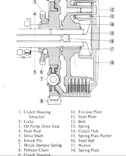

But where does it go exactly? On my clutch diagram I cant see it. I've attached a picture of my diagram
Is it the spring plate pusher?

Yes but it doesn't look like the one in the diagram. Take some pics when you have it open again. Someone may have switched parts. The ball is listed too. It goes in the end of the primary shaft.

This is from the 440manual but the general idea should bethe same
The the ball comes between the pushrod and the pusher plate
