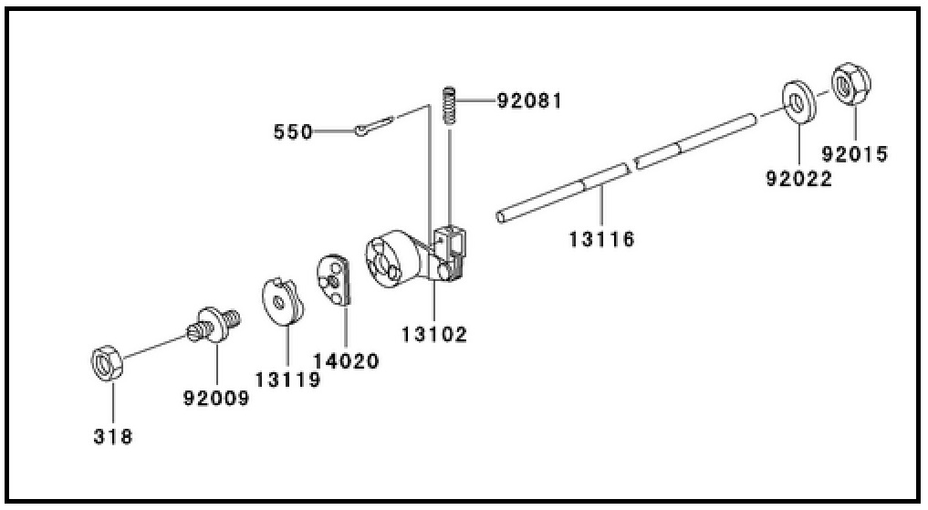

If it's the EZ pull (ball and ramp). it will go too far and you'll hear a pop. My 350 Honda did it all the time until I learned how to do it. They sell EZ pulls but I did my clutch mod instead.

2001 KZ1000-P Clutch Actuator assembly as shown in the Clutch diagram from Kawasaki.com

Ok Got it back and I think I have this figured out.
When I adjusted the clutch I used my FSM for the KZ1000 clutch adjustment procedure which says to turn the adjuster clockwise until it becomes hard to turn and then back off 1/4 turn. My Clymer KZP manual says to turn the adjuster counter-clockwise. The Clymer manual is correct.
So the adjuster was clocked too far over and eventually (160 miles) it just over-extended.
I could have fixed it on the side of the road but it was raining, I was in a poor cell reception area and the wife was none-too-happy.
I'm glad it was not an expensive fix but now I get to work on the low oil pressure and oil leaks.
