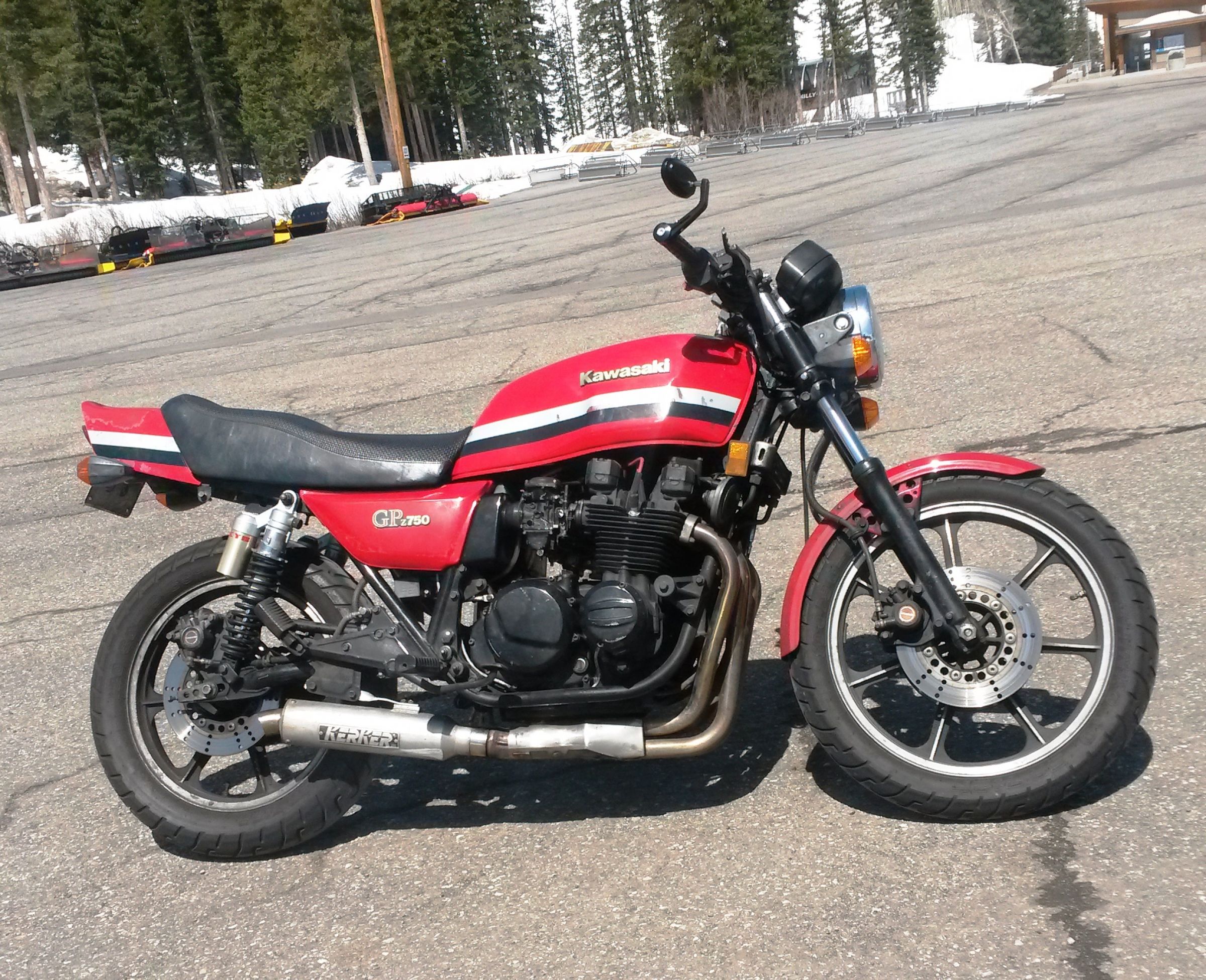

10 May 2016 13:32 - 10 May 2016 14:01The easiest thing is to cut it behind the collector and either put an aftermarket pipes and muffler on our adjust the orientation of the pipe and muffler.turboguzzi wrote:I actually got also the zr-7 exh system and i do like quite bikes but after trying a bit for fit, i decided against it. it weights a ton and would require a big change of the right passenger footpeg and silencer hanger.The Gringo wrote: Cool swap too bad you didn't get the exhaust with the engine as well. I put one on a 650 I had and man is it nice. Whisper quiet, made with stainless steel and really performs well.
i am keeping it for when the light Sito system i have will rot through, so it couold be interesting to see how did you solve the area of the rear right side. mind posting a pic?
I got mine for under $100 shipped on eBay but it was already cut and came with a Kerker muffler and no mid pipe. I just got creative and made it work. I found a titanium Muzzy with stainless mid pipe that I'm going to refurbish and attach eventually using the rear peg attach point.
The scrape marks on the Kerker are from when it hung a little too far out to the side and before I put the longer shocks on.

10 May 2016 16:52 - 10 May 2016 16:53turboguzzi wrote: interesting solution but definetely not my cup of tea in terms of looks for a street bike. please dont take it as as an offense, my vintage road racer setup with an R6 Ti silencer is quite a bit like yours. in any case, not doable with the much bigger stock zr-7 muffler if you want it to be quiet too. your kind of muffler would be an instant cop magnet here in northern italy. gringo, westill want to see your solution
Attachment exh.jpg not found
A temporary solution, my bike is ugly right now but it is running awesome compared to when I bought almost a year ago. The Muzzy which is off a R1 so it probably wont be as loud as one would expect and will probably end up looking like your race bike. I didn't like the stock pipes and they were in need of some attention so I sold them recently, They should be delivered today as a matter of fact. My point is if you don't want to adjust the bike for the pipes you can cut the pipe to suit the bike and your tastes.
