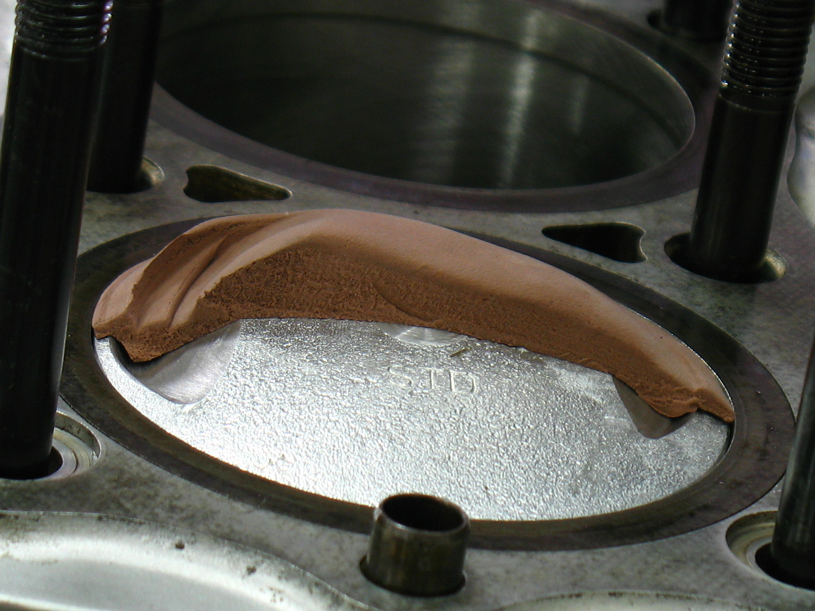

The only change I made to the stock std. J pistons, was to open the valve pockets a little for extra clearance for the 84 GPZ cams in the ZN head...
Boy, do she fly! :woohoo:

29 Apr 2016 20:08Kray-Z wrote: For anyone reading this![]()
- I have done some research and this is what I have found.
The 83-84 GPz1100 head is not a hemi combustion chamber like the older GPz's and most KZ's.

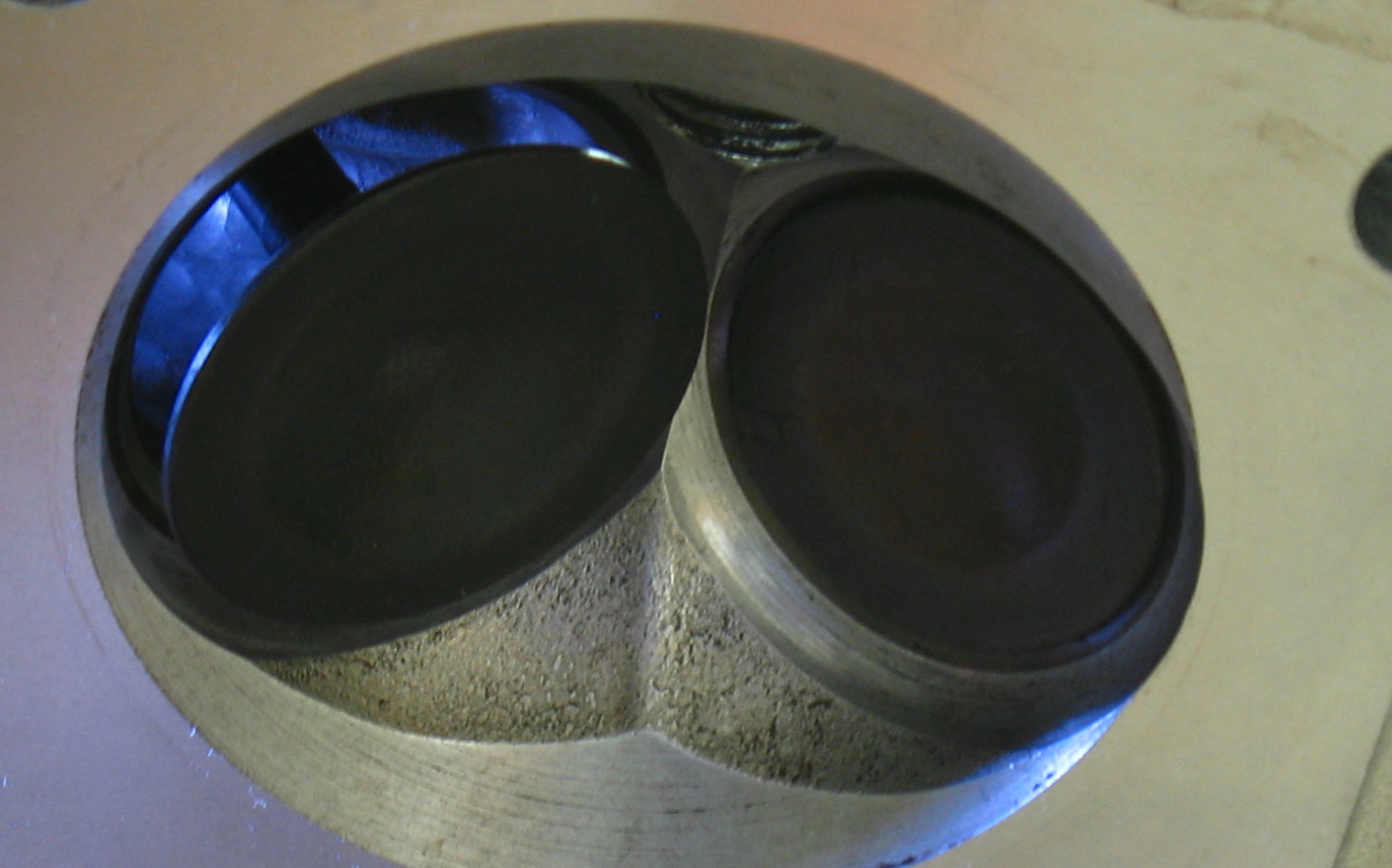

For reference
1982 KZ1100-A2/1170 sleeper 😀

02 May 2016 01:56Hey daveo,
Thanks for that photo. Nice job fly cutting the stock pistons!
I never checked the stock, low compression, J pistons for clearance! But having said that, I still think the piston to head clearance must be extremely tight with those pistons and the late GPz bathtub head...

02 May 2016 02:00Just want to add that daveo's photo is the chamber of the late model "GPz" aka "Bathtub" head...note the squish bands on the sides of the chamber and the separate valve pockets...

02 May 2016 06:37Kray-Z wrote: Hey daveo,
An extremely accurate, high-tech fly cutting system :lol:
...and for assurance of critical clearances :lol: :whistle:

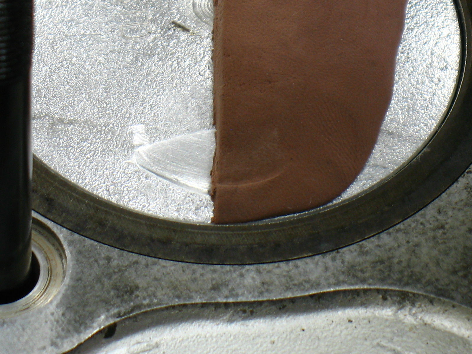

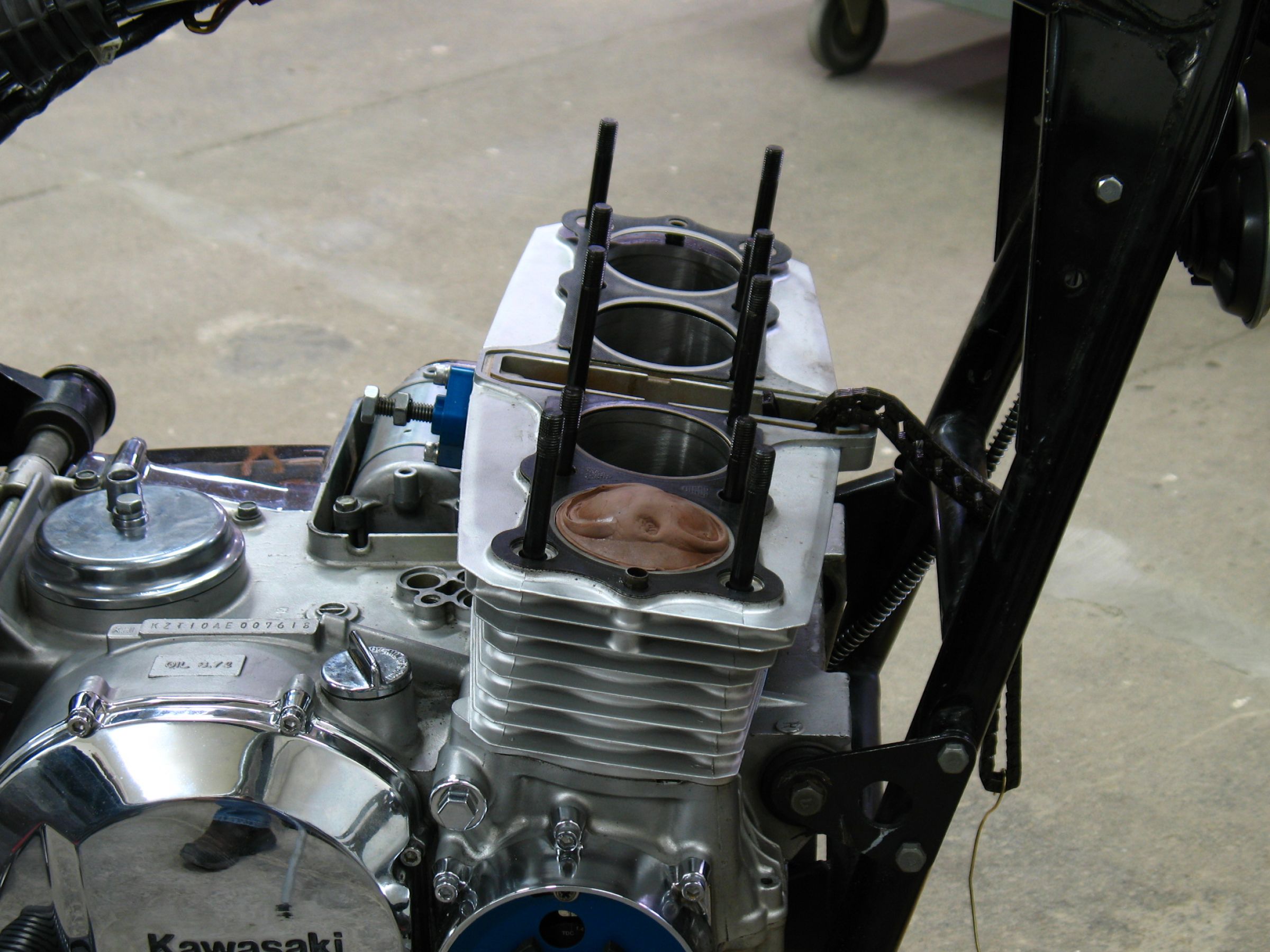

02 May 2016 18:28 - 02 May 2016 18:32Kray-Z wrote: Did you check the squish band area - piston to head clearance - with your modeling clay also?
I did not measure the clay other than at the valve pockets. The pics below provide a glimpse of my process, and may offer an answer your question. I took a lot of pictures, since I was geeked about the project, having such limited experience with such things.
Before
After
Close-up
