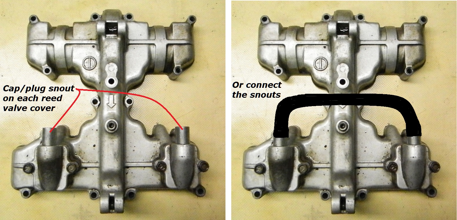

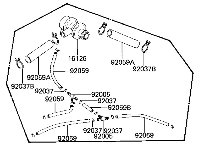

KawiBunga wrote: . . . Also how can I and what are the repercussions for removing the...what looks like a emissions system?
Click > www.kzrider.com/forum/2-engine/590640-he...to-his-82-csr#602307
May remove the clean air paraphernalia shown in the diagram below.
Don't leave any carb vacuum nipple uncapped, because an open vacuum nipple causes an air leak. :pinch:
If the shorter 92059 hose supplied vacuum to the petcock, would attach a replacement hose from the petcock vacuum nipple to one of the carb vacuum nipples previously used for one of the longer 92059.
And cap or plug the snouts on the reed valve covers, or connect the snouts together.
There's no need to remove the reed valve covers.
And the reed valve assemblies located underneath the covers should remain intact and undisturbed.
Good Fortune! :)

I've been running my valve cover hoses into each other for a month. So far so good. Had to rejet for K&N air pod filters. I'm at 145 main and 52.5 pilot. Running sweet now.
