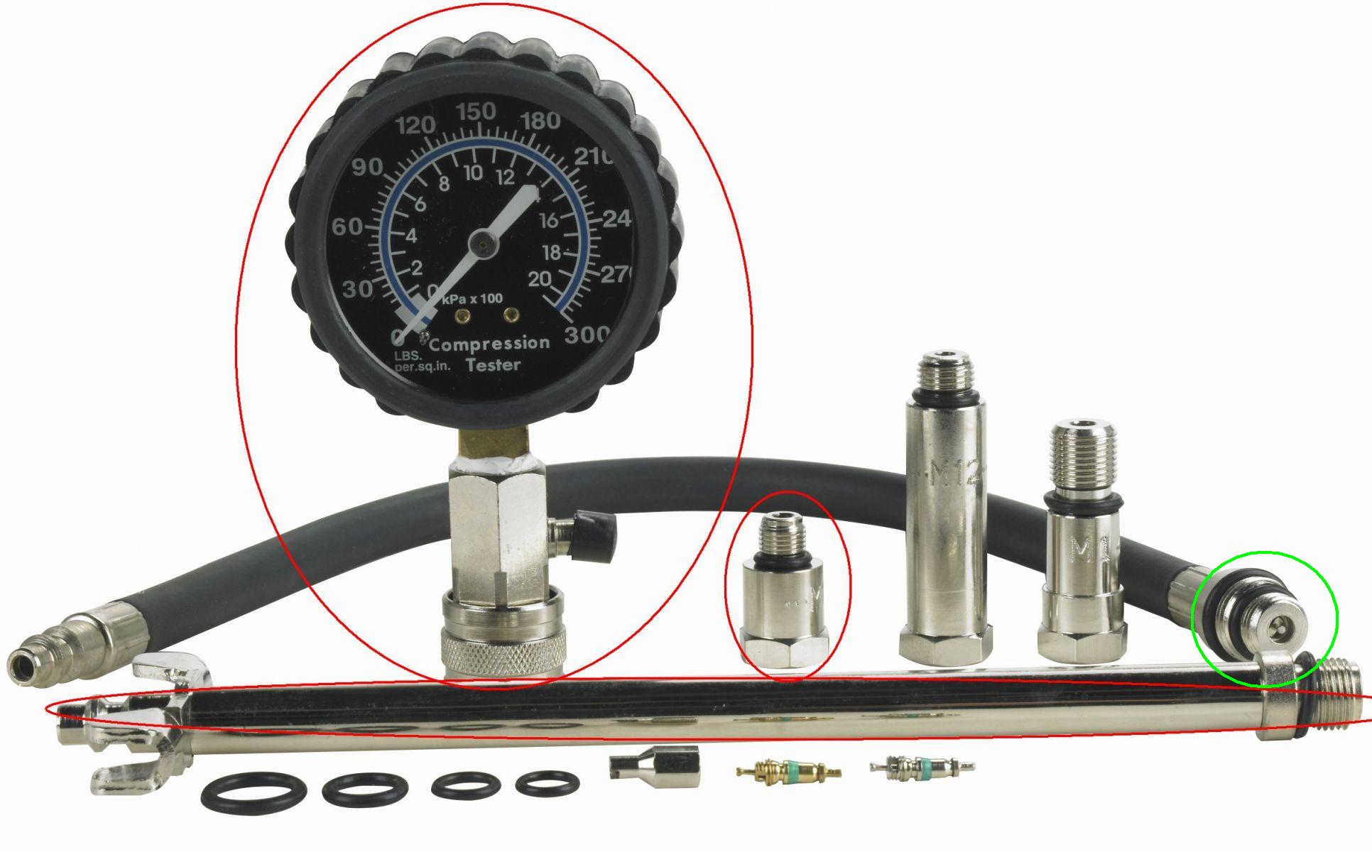

- rrsmsw9999
- Posts: 775

- loudhvx
- Posts: 10863
- Thanks: 1622
Re: Compression numbers
29 Jan 2016 12:56 - 30 Jan 2016 08:37
No, not if the check valve is in the spark plug end, like shown here in green circle.
Then it's good.

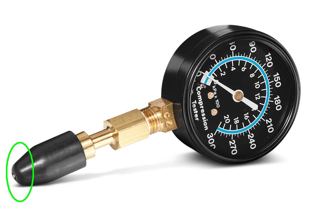

- loudhvx
- Posts: 10863
- Thanks: 1622
29 Jan 2016 13:08
BTW, when the gauges don't have a check valve there, they don't suck, they blow. :laugh:
But either way, they read lower.
Here's what the tip of a hold-in type, or hold-in adapter should look like.
