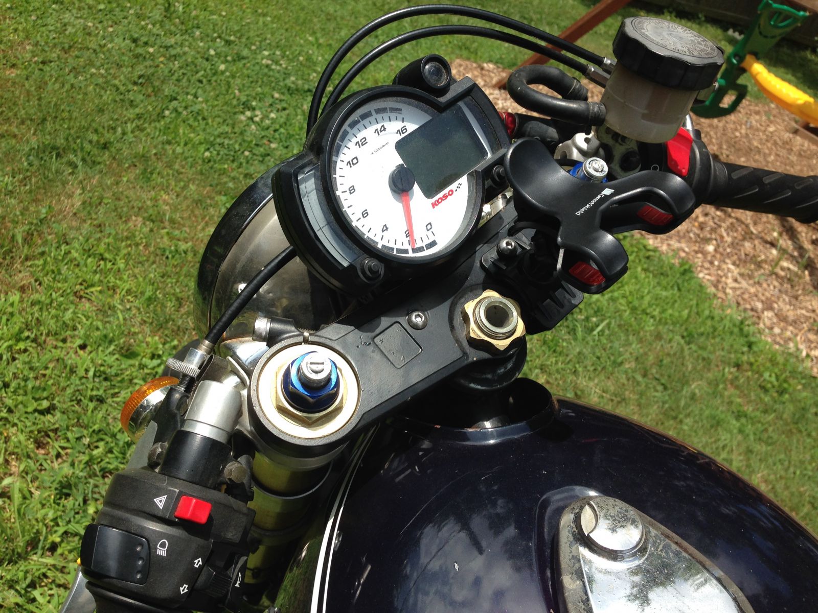

missionkz wrote: What are u using for a tachometer?
Koso
