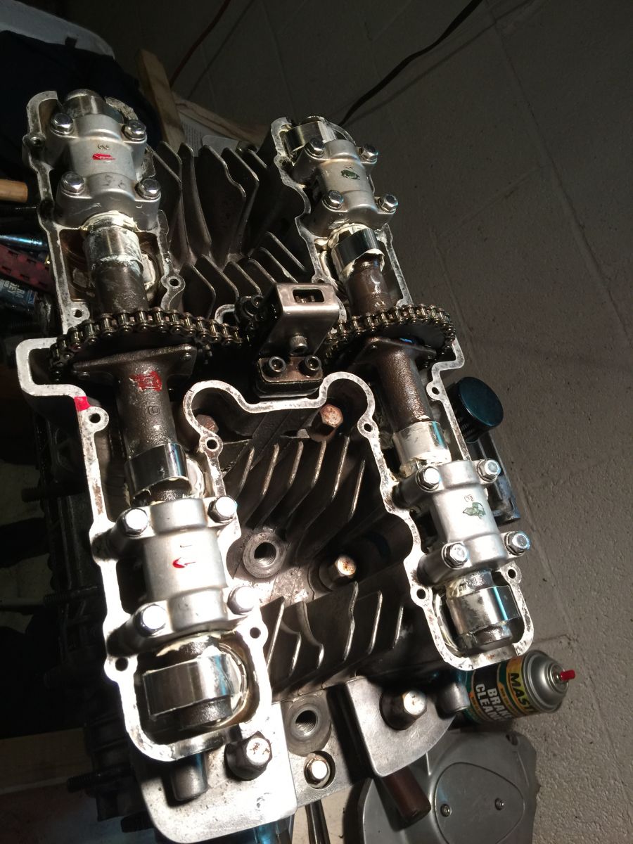

2 stock 77 kz1000 intake cams(factory exhaust cam swapped for a second intake cam)

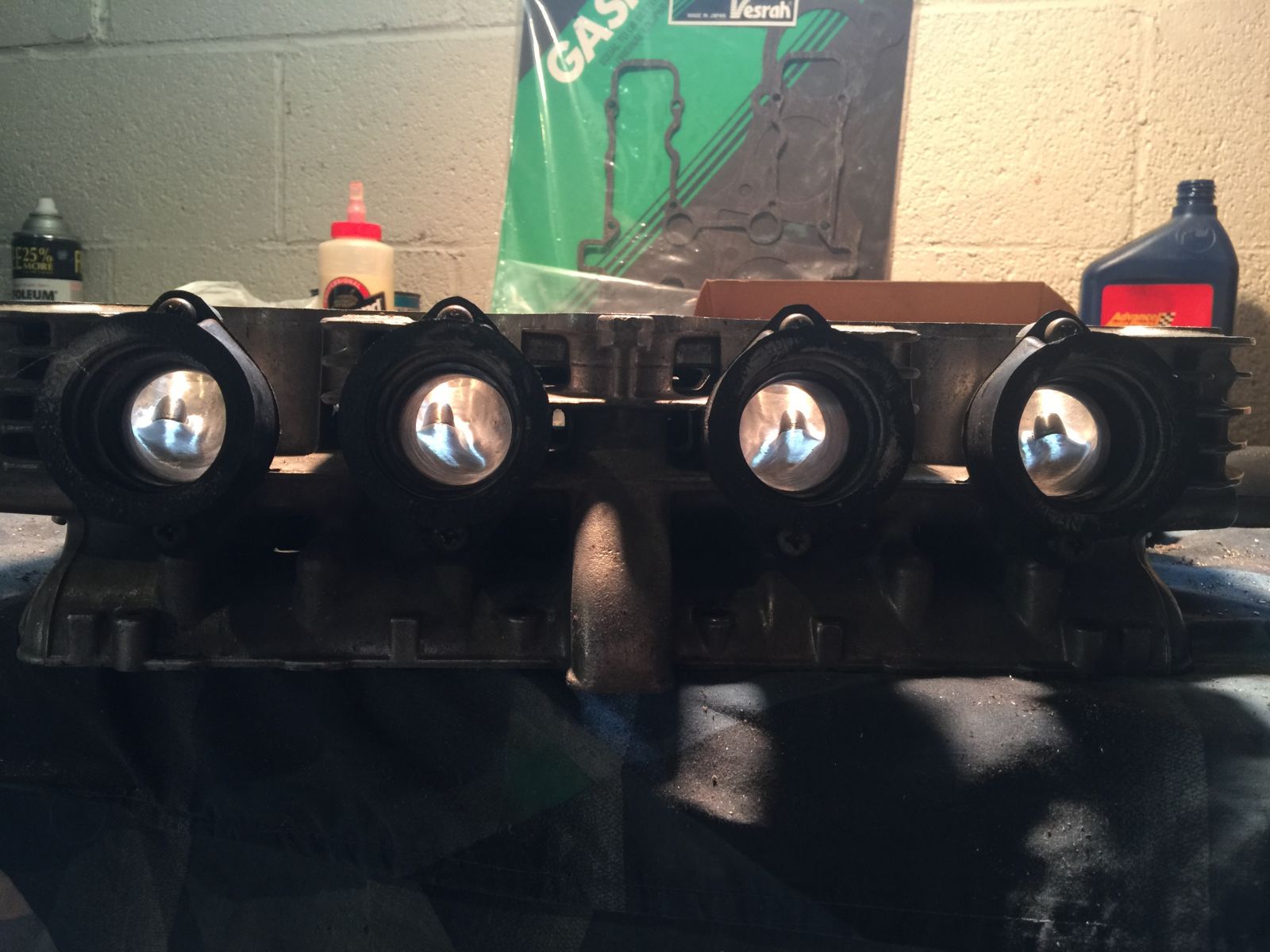

Intake

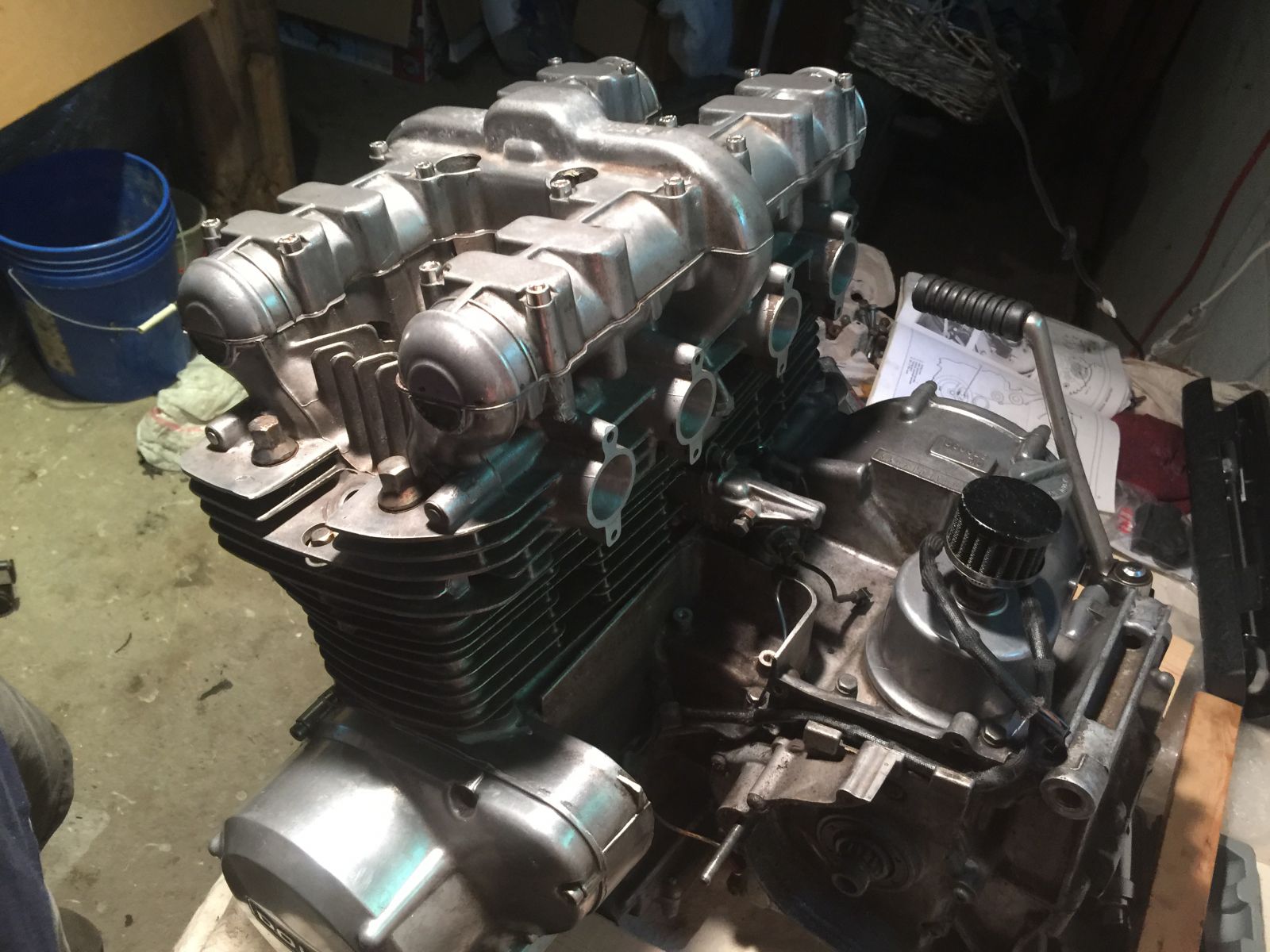

Valves in
Double intake cams
Almost ready to go

Intake

Valves in
Double intake cams
Almost ready to go
