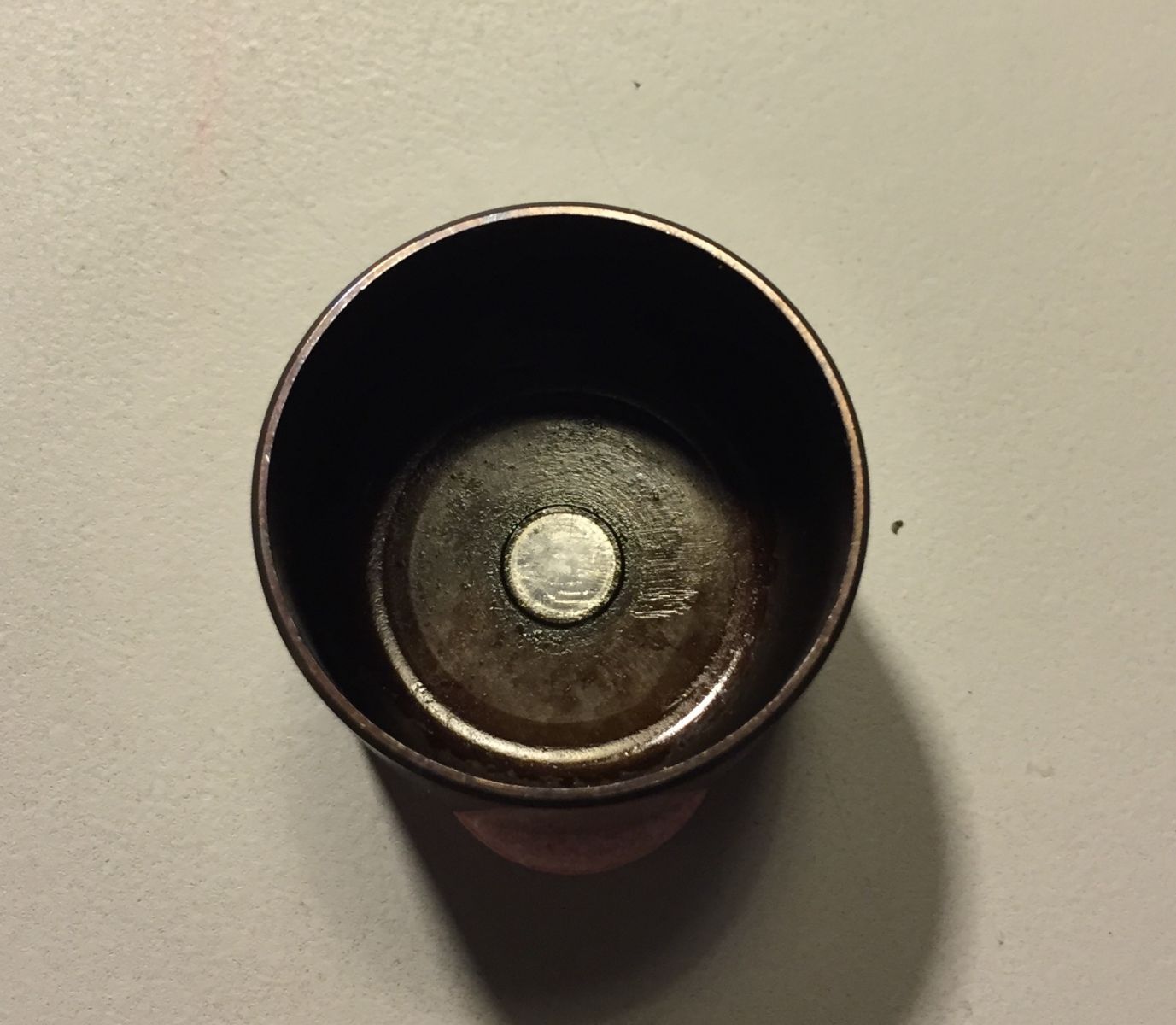

I've also read you can grind off a couple thou from the stem button under the bucket.
Anyone??
Anyone??

Right but I was talking about the little button inside and under the shim bucket....
Probably dumb....
Probably dumb....

Tipping the valves .010 is good. Tipping the valves and grinding the bucket "button", DISASTER. Think about it, the button keeps the lifter cup from hitting the valve spring retainer.
