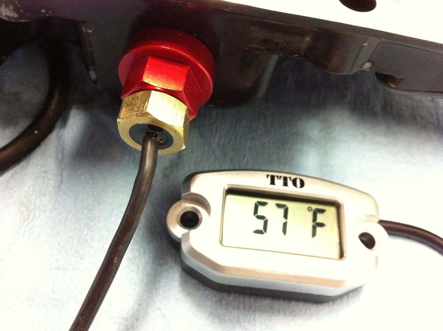

I used a Trail Tech Oil Temp Gauge on my race bike with great success. Drilled and tapped into the side of the oil pan to get true oil pan oil temperatures, with no leaks. I use to run a Daytona temp Gauge, but i didn't like it, too many wires. This trail tech ran on watch batteries, and never killed them.
