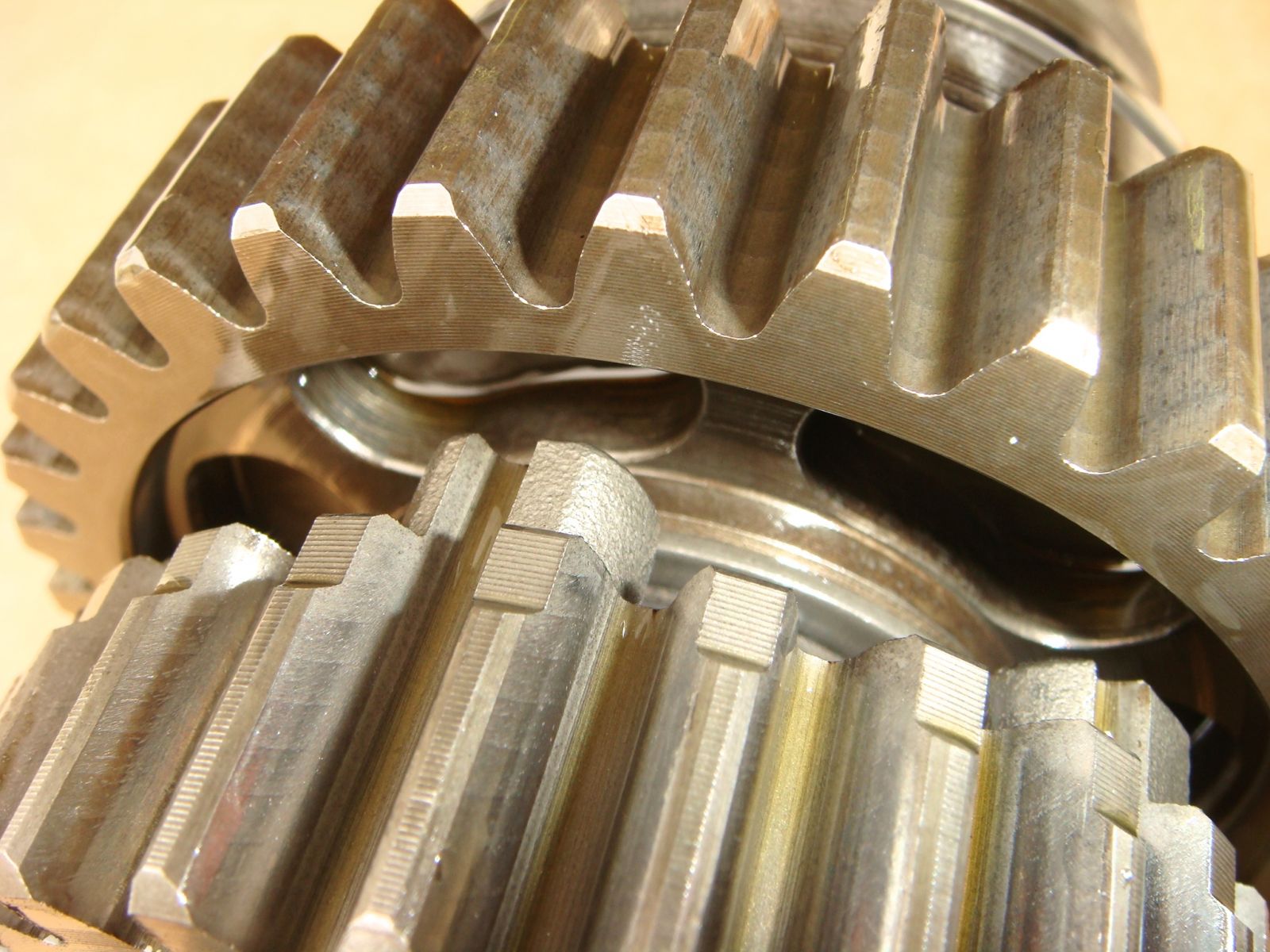

Most likely the transmission gears are wore. This is most common in second gear. Easy to see when you get them out. There are not a lot out there with perfect gears after all these years, they all have some degree of wear. You can take the oil pan off and its not easy but you can get a look at the gears. You'll be looking on the output shaft for the 2 gears closest to your sprocket. They should look like these but they get rounded on both sides of the gears.
