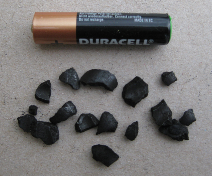

Let us know if you find anything inside there that looks like this:
:lol: :lol:

Patton....ROTFLMAO!
