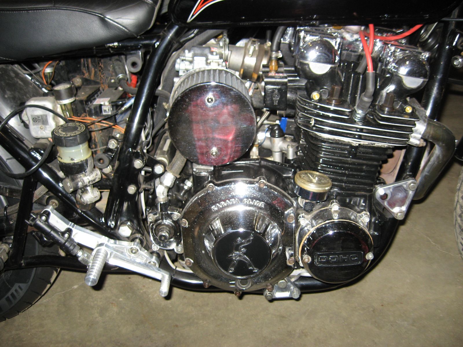

Found this image in the search function. (but no answer) posted here-
69.46.28.106/forum/2-engine/110148-oil-l...ype=raw&limitstart=0
Not worried about them coming out Larry, but they are leaking oil slightly, just enough to be annoying, l,m prepared to pull head to rectify but looking at a spare head, looks like cannot access to seal up, other then drill and tap a rod into it but will look pretty ugly if l do that.
69.46.28.106/media/kunena/attachments/legacy/images/headt.JPG
