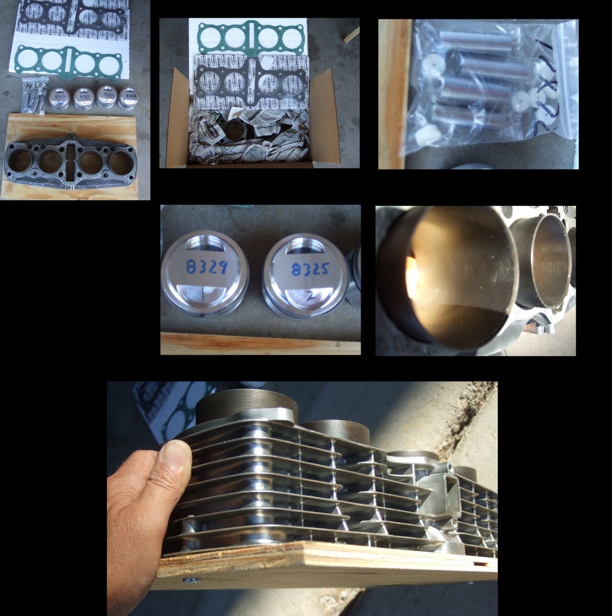

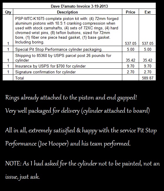

I say this Because over time ended up going the same thought process / route....
Started w/1015cc build, then wanted more umphka... :pinch: Should of just went 1075cc from the start for I have built this engine so many times now it's ridiculous... :whistle:
Take the 900 engine out and have the KZ1000 engine bored to 1075... This way you won't have to bore open the top case for the cylinder sleeves. All internals are for the most part a direct swap, crank, tranny, drive shafts, engine cases etc...
NOTE: W/1075 displacement, definitely replace timing chain, guides, rubber dampers etc....
Replace all engine seals & gaskets. Check the crank bearings as well. If not truly racing, crank doesn't need to be welded for a 1075 build. Yes better if you do and have the funds but not required for normal driving, occasional throttle twisting.
And you'll have a good KZ900 engine sitting there for later use, another build whatever...
You'll gain ~ 200 cc displacement!!! Other than the cylinder 1015 stamping, no one will know for the most part. Twist her up on another bike and they will be surprised how the old girl pulls away on them. ;)

Cool, thanks for the advice. This is looking like my best option to get displacement with the engine and parts I have without having to re-sleeve. OMR - Did you send your jug to Pit Stop for boring and rough installation of the 1075 pistons as per your picture?
