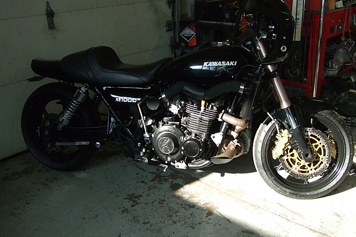

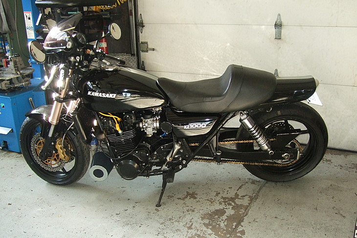

Here are a couple pictures of what it should look like. Turbo up front, thru the intercooler, then to the carbs or injectors. Figure 5 to 8 Grand easy regardless of low boost or not

hell dave thats what all kz's should look like :whistle: :laugh: :evil: !
turbo or not :silly: .
that thing should have " i need a spankin " painted on the tank :lol: ...
Last edit: 10 Jul 2013 10:45 by 531blackbanshee.

10 Jul 2013 11:02531blackbanshee wrote: hell dave thats what all kz's should look like :whistle: :laugh: :evil: !
Hey Leon,
From one hotrodder to another I must agree.
These KZs were made to run wild. And I do all I can to make sure our passion to go fast and dominate the motorcycle world lives on. :evil:
Cant see the point in a 3 to 5 pounds of boost turbo , But to each his own. :blink:
As Bill Hahn use to tell me, "Racings Cheap, Winnings Expensive"

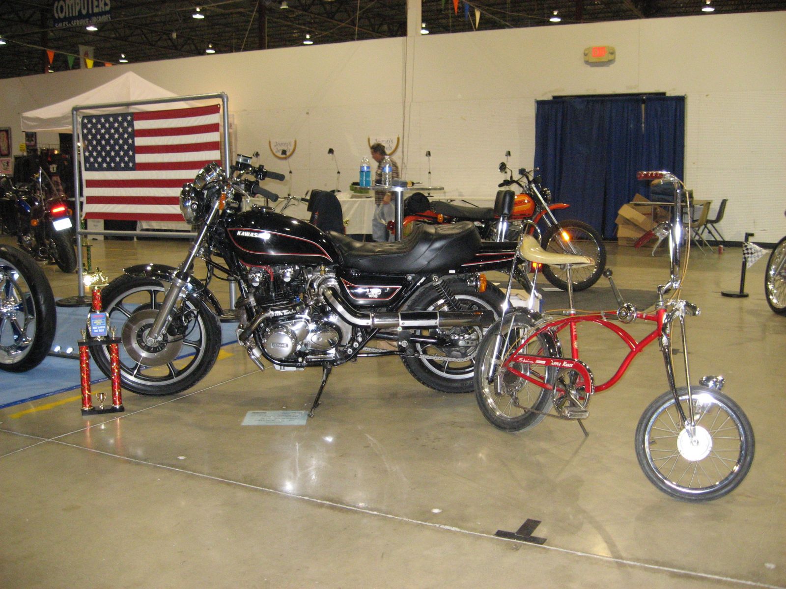

10 Jul 2013 22:35That bike is not mine. I found those pictures while surfing last year and admired the layout and execution of the design. It is a great example of a custom turbo setup. Design is a lot like a Kaw 750 Factory turbo, just bigger.KZ-Izzo wrote: lol fuck thats sweet as all hell. i can get all the parts for really cheap/ build parts myself just where would i find a hookup for the carbs and how big an increase in jets? and damn 3-5 you dont see a reason.. lol seems like a bit for a normal rider, how much are you pushing through that bike?
I run 15 to 20 pounds of boost all the time on my bike and I take it up to 30 when someone needs to be spanked or my son is on it and he is not afraid of it at all.
Here is a picture of mine . Its a Mr Turbo Kit I installed in the early 80s. So I can testify if you build them right , they will last.

that black turbo intercooled kz belonged to a guy that goes by turbo wade, theres a utube vid of him running a flat nine after kick starting it, its a very nice ride, i prefer les holts tho, the craftmanship is amazing.
