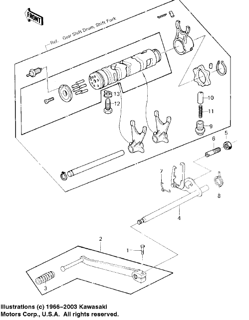

Clutch? Is the clutch slipping? Otherwise I would suspect shift spring, this would not allow the engagement of the shift pawl.
Post the year and model, someone will post a transmission/ shift diagram. Or you can go to kawasaki.com, and owner info, parts diagrams and look at it there.

Have a look at the diagram for the shifting, and look at the spring (#7) that goes between the two pawls, which turn the drum. Could be the spring, or sometimes the pins can come loose and fall out of the drum. Could be something else also, like a fork, but then you should get the gears on it.

Be sure to install the special lock washer under that nut (see diagram). It is still an "Active" part, so any local or online dealer can order it for you if yours is missing. Ed
