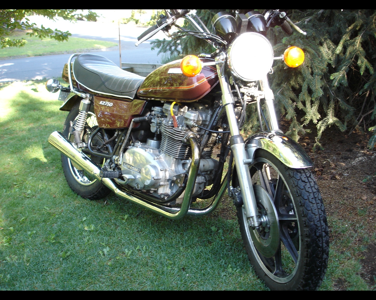

24 Jan 2013 13:26 - 24 Jan 2013 13:29I fitted this two into one MAC system onto my 750B4. One of the flanges wouldn't fit up against the head good enough to seal. I used a piece of closet dowel to tweak the pipe around so that the flange would mate up.
Once I got the jetting right, took a couple of tries, I've been satisfied. At the time MAC was the only company selling a two into one system for a twin.
Bill
Had to use IE to post this pic.
This is the same set I put on my B4. I got it used, it was pretty good quality, fit easily but I do have to use double gaskets on one port to get a tight exhaust seal.
It jets same as stock: 125 main jet, the 45 pilot runs OK but a 50 pilot jet runs better.
Bill
I do like the exhaust sound. It's got a good punch without any sharpness.
