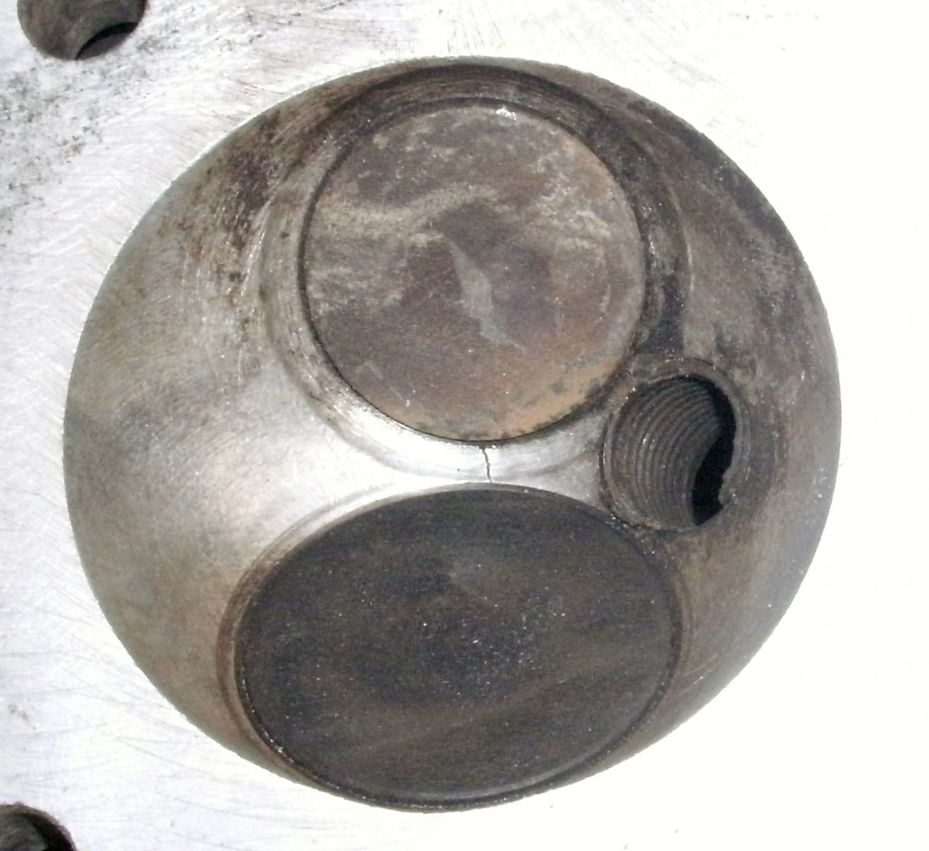

Gut feeling is that increasing valve head diameter size would increase tendency to develop crack in head between the valves. At least with respect to long term street riding durability.
www.kzrider.com/forum/2-engine/558556-head-crack#558610

Did I see a question earlier about that small crack between plug hole and valve seat?
I know that is common. I have used stock heads like this before.
I have a nice ported Mark II smog head.
But I see that tiny crack at the plug hole. You need a magnifying glass to see it.
I would hate to sell it this way.
I used 37.5mm intakes and 31mm exhausts in stock seats before.

Never saw one crack from installing oversize valves. There's more seat material in those heads than any other Kawasaki head I've ever seen. Besides, it's not the seat that cracks, it's the aluminum.

Your right Larry, it is the aluminum of course. The seats don't crack.
