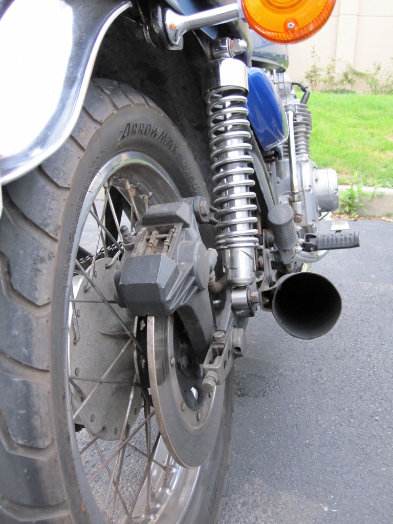

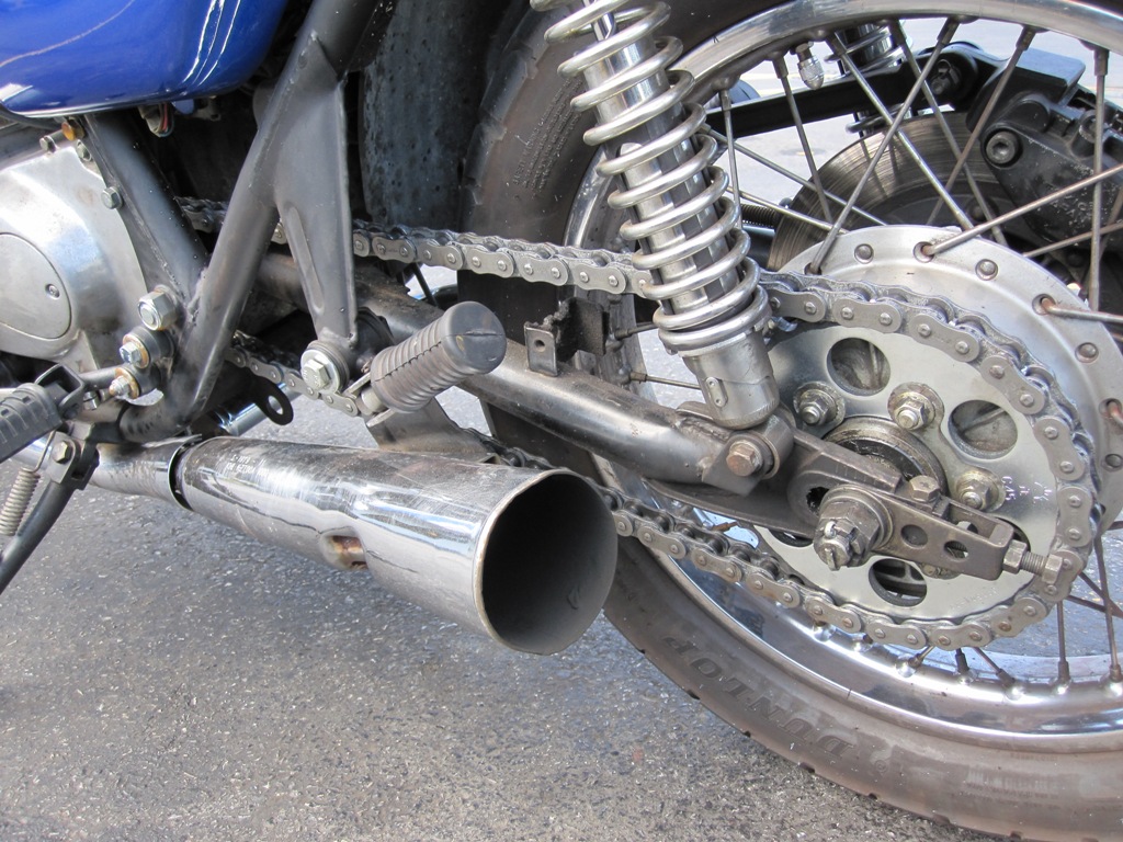

This guy did exactly that, I plan on doing the same (I love the dual exhaust look). I wonder if he had to re-tune?
