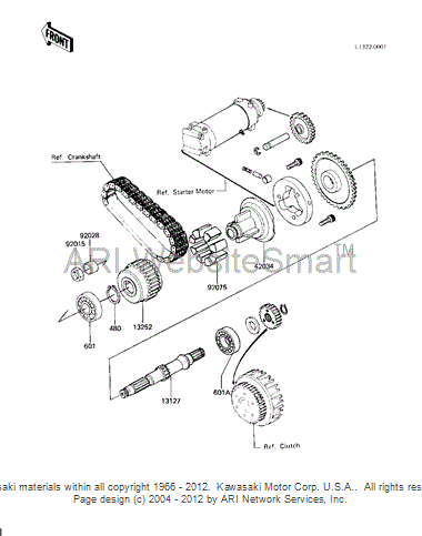

Sorry I don't have a workshop manual for that bike. But here is the parts fiche which shows the assy.

Thank you Motor Head. That pic is in the Clymer book. I'm just not certain what else I can remove from the secondary shaft in order to remove it from the case so that I can rebuild my starter clutch. The only thing I can think of is the circlip on the starter side. But this doesn't make sense to me since you can't simply access it.

In the Parts Fiche it shows the snap ring at the clutch basket. So I would take the clutch cover, then the clutch apart, then remove the snap ring. So it looks anyway. I don't have the twin, but that looks pretty straight forward.
See in the fiche wear it says "reference clutch"?

I just noticed the difference on the pic! Mine is the 4 cyl. So the clutch assembly is on a seperate shaft. Now as I mentioned earlier, the only clip I find that may be retaining anything is on the (sitting) left end of the shaft. But this wouldn't make any sense since there is no room to slide anything off inside the case. It seems as though the whole shaft is supposed to be removed but because of the gear on the secondary that gets driven by the starter, it won't budge any further. And I don't see any way to remove it. Unfortunately, the Clymer book isn't exactly being a roadmap about this part of the removal.
The book reads, "tap the shaft towards the clutch side of the engine till the bearing is out. Pull the secondary shaft out (which I can't because of the above mentioned gear) Then remove the secondary sprocket." This is why I need help...

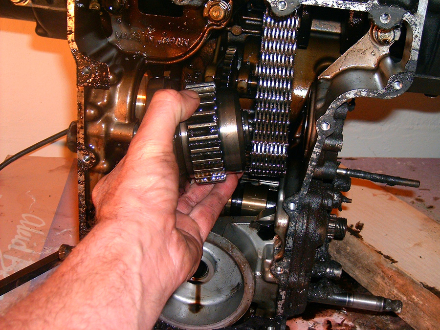

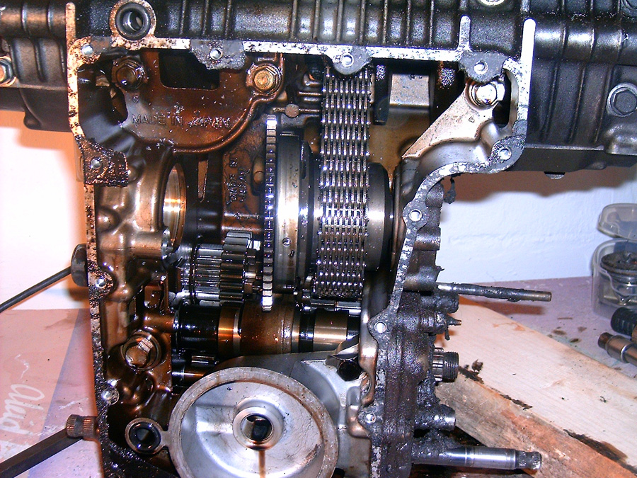

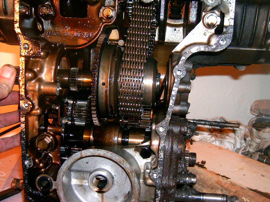

You only remove the shaft, the large sprocket (starter clutch gear) and the starter clutch housing stay in the primary chain until the shaft is out, then they can be removed.
The housing may be a bit tight on the shaft, it sits on splines, but there are no clips or anything holding it. The snap ring you mention doesn't sit on the shaft, it sits on the starter clutch housing opposite the sprocket - no need to remove it unless you want to take the housing apart. Hold on to the housing and pull/tap the shaft, it will come out eventually.
Likewise, when reinstalling you place the housing and sprocket in the primary chain, then insert the shaft - don't forget to install the spacers on each side of the sprocket roller bearing.

Dude you ROCK! Ok, I was afraid of using too much force that I might damage something. So now my intentions are to place some rags between the driven gear and the case and continue to tap away! Thank you so much! And thank you again to everyone for your input, you guys are great!
