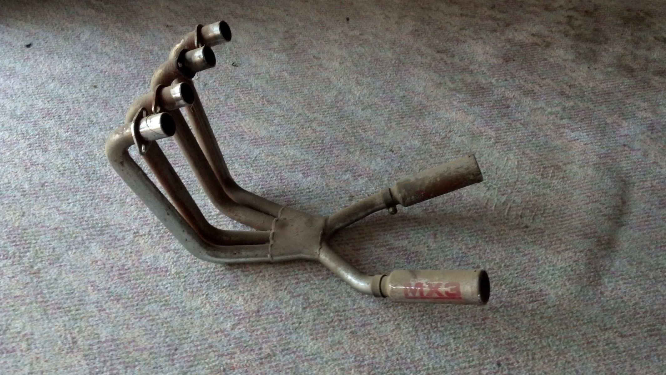

I was at a friend's house last week and he pulled out the most bitchin' Z1/KZ exhaust system I'd ever seen! Anyone have any idea what it might be?

is it a stock header with universal baffles? looks tits tho

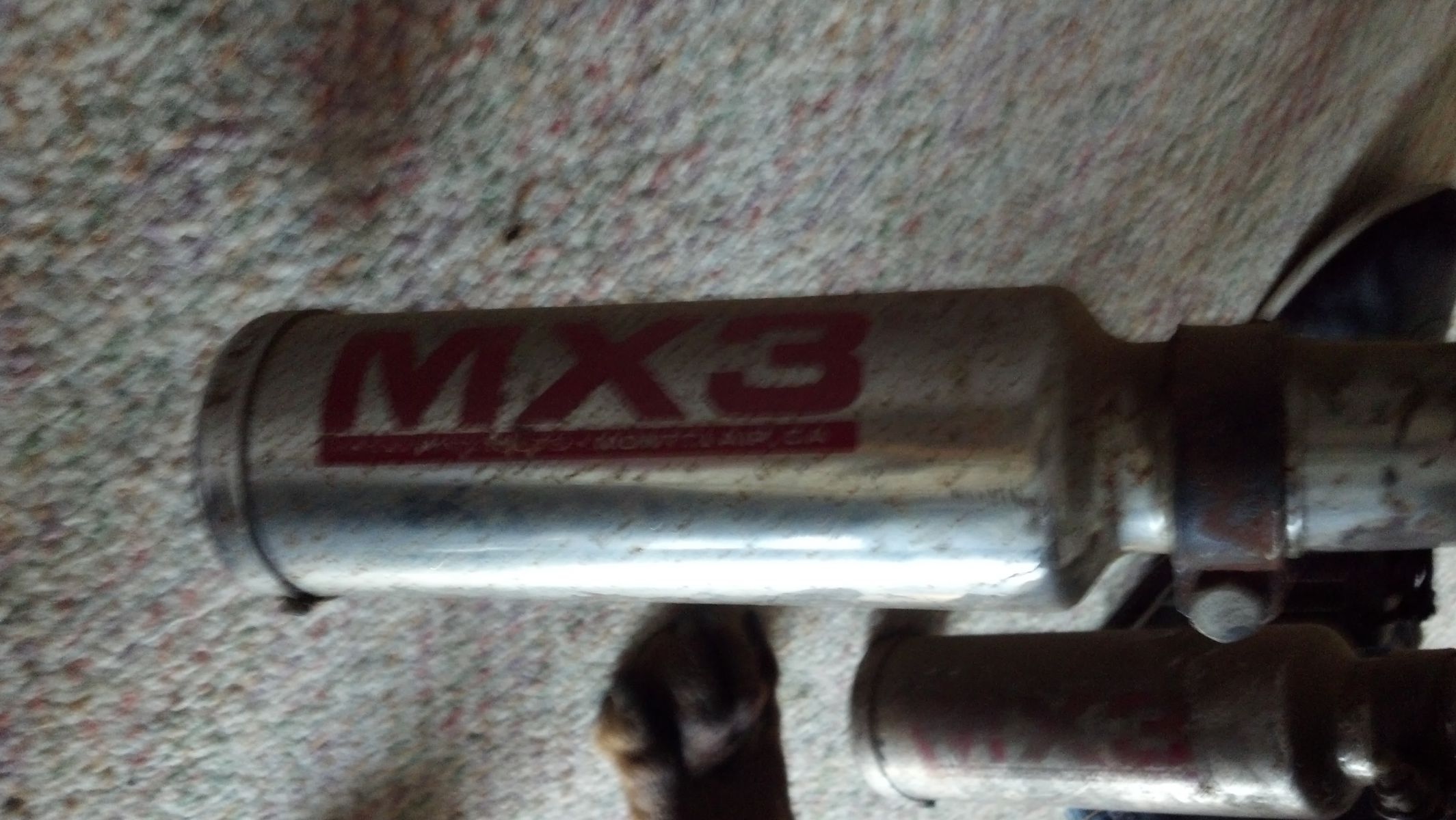

That is a Murray x pipe. IMO one of the best pipes for the z1. It makes it's power in 3 stages, 4000 rpm, 8000 rpm, 12000 rpm. That is a rare pipe.

21 Jun 2012 03:47oldkaws4ever wrote: That is a Murray x pipe. IMO one of the best pipes for the z1. It makes it's power in 3 stages, 4000 rpm, 8000 rpm, 12000 rpm. That is a rare pipe.
x2 id love to have one of those amazing sound
and no you gotta drop it to do the oil and filter
rare pipe

the one on ebay is a copy the one at the start of this post is a origanl murray very rare
nowadays
i think hes still making them but could be wrong jacks bike was useing a murray spider i think
the one at the start of this post is worth a few bucks
the sound they make is wild
nowadays

pops yosh never designed a 4 into one for a canadian or us bike my ass
im running a origanl yos from about 73 or 74 on my kz 1000 z1r right now
the only thing cambell did was rebadge

Any legitimate dyno-testing been done on the x-pipe?

I remember reading ads back in the early 80's from performance "X" pipe builder named Monty Campbell out of Cali that also made that exact type of pipe. The pipe was called the "MAXI-X" What a unconventional "goofy" looking pupe. Probably the reason you don't see too many of those pipes.
