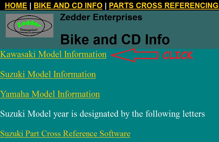

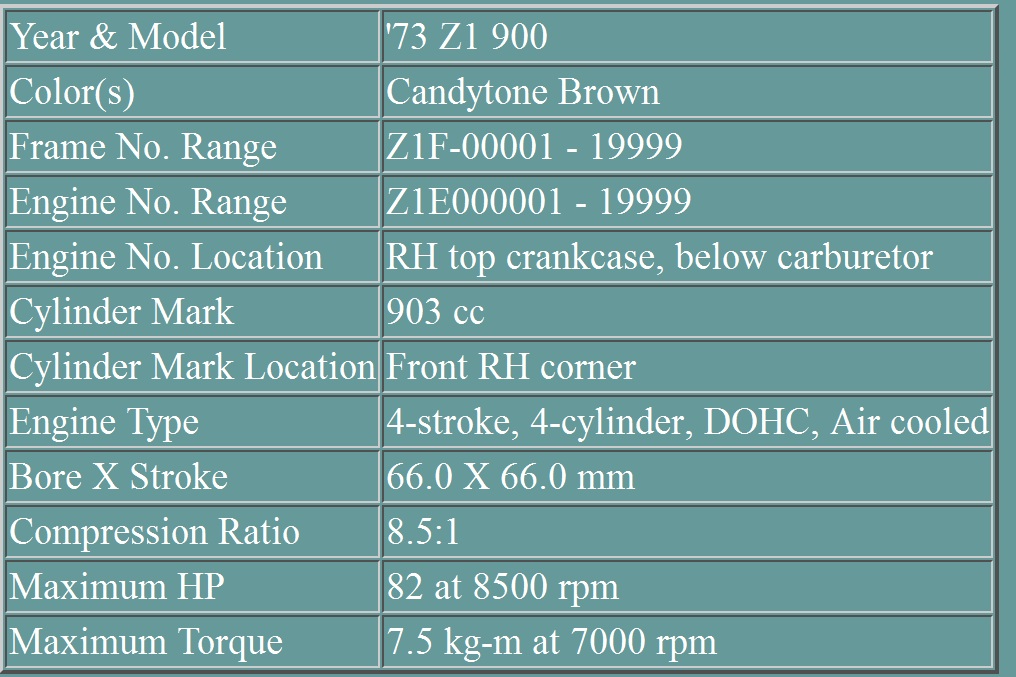

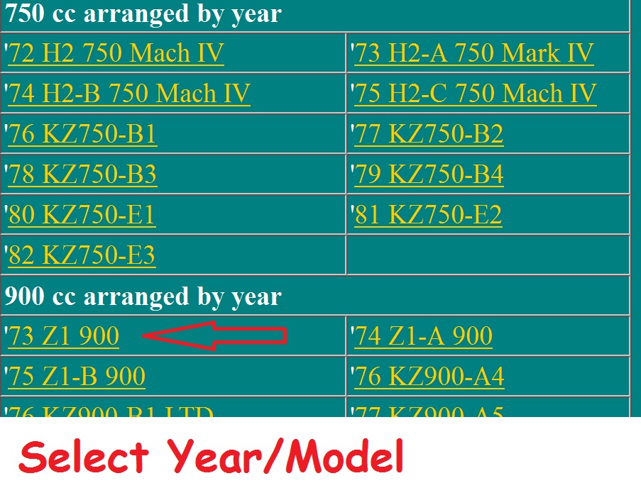

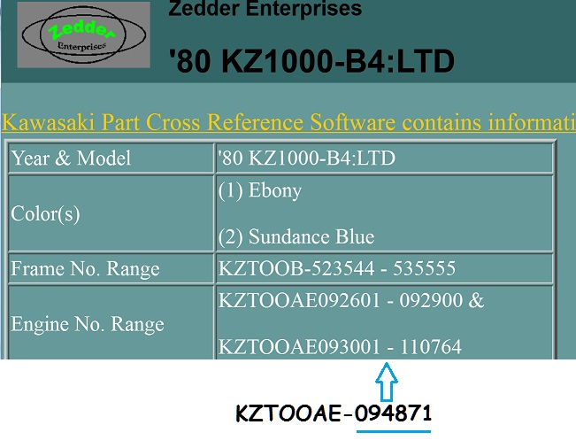

If needed, here's a way to navigate www.Zedder.com :
