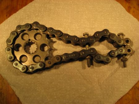

If you have some spare chain handy you can make a tool without much trouble. Just get a stout piece of pipe, drill 2 holes in it, wrap the chain around the front sprocket, and run 2 bolts through the chain and pipe (as shown in pic below; note the bolts circled in yellow). Then you can use that to hold the sprocket while you use an impact wrench or breaker bar to loosen the nut. The threads on the KZ650 are normal, not left handed. Ed

02 Dec 2011 12:23 - 02 Dec 2011 12:41650ed wrote: If you have some spare chain handy you can make a tool without much trouble. Just get a stout piece of pipe, drill 2 holes in it, wrap the chain around the front sprocket, and run 2 bolts through the chain and pipe (as shown in pic below; note the bolts circled in yellow). Then you can use that to hold the sprocket while you use an impact wrench or breaker bar to loosen the nut. The threads on the KZ650 are normal, not left handed. Ed
