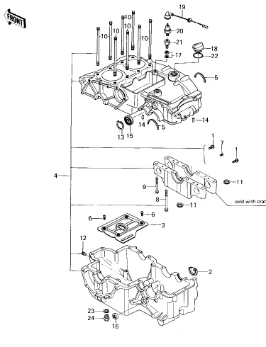

Sounds like pulling the oil pan for an inspection, and at least cleaning, would be a Very good Idea. Sludge can block/ restrict the oil pump intake, causing low pressure/ volume in the motors oil gallies.
Well Patton just informed me that the 440 has no removable Oil Pan, so scratch that.
But Sludge would still be a oiling issue.
