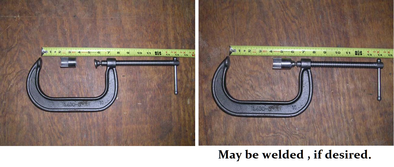

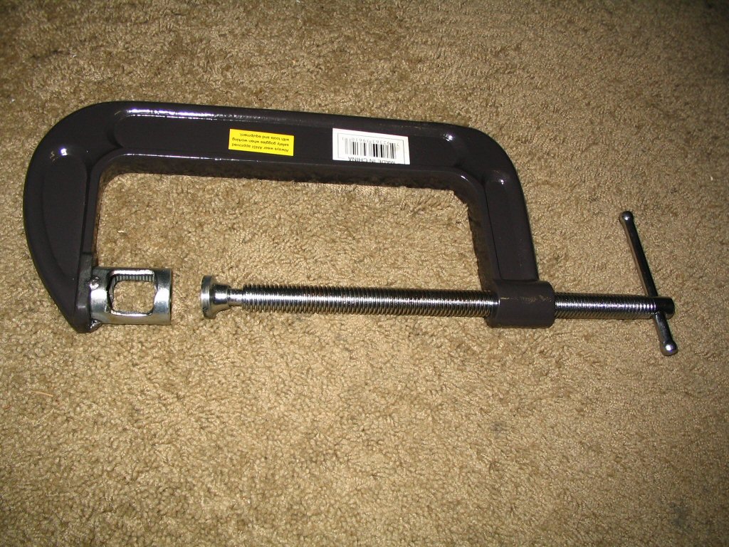

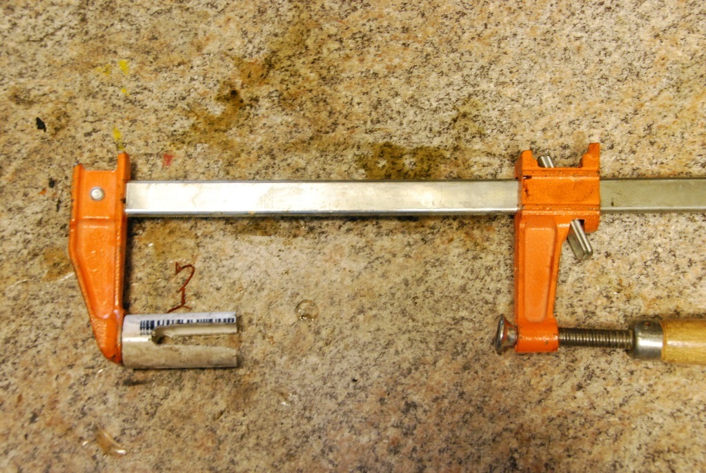

Ideas for a diy valve spring compressor tool.
